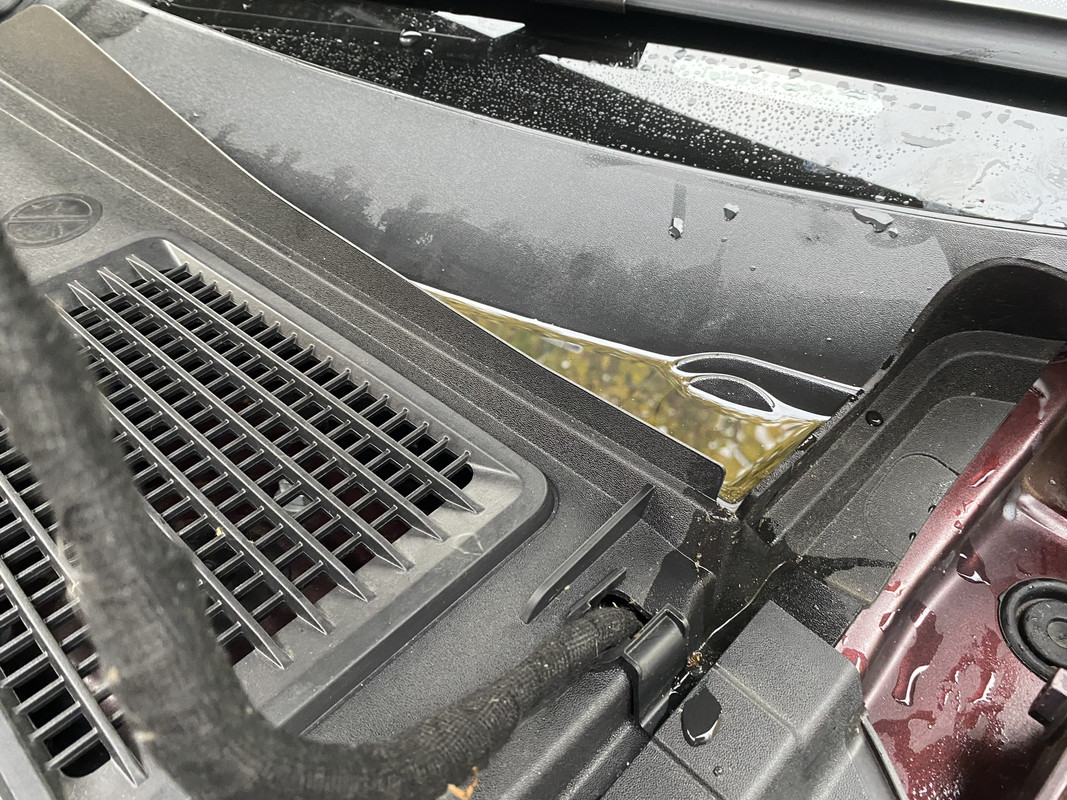

Been noticing water not draining away on nsf under the windscreen. On other side it drains away freely. Checked for and removed leaves and for any obvious signs of blockages. When looking closer at the black plastic sill it’s not been sealed at all well on that side too.
Has anyone had this problem?

On the MK7, there's only a drain hole on the o/s so if your car is on a slight lean towards the n/s, water will settle assuming it's the same as the MK7.

Thanks for the reply. I thought only one drain on the offside. I didn’t have any problems with my Mk 7 which was parked in same position. It’s only just started doing it and I’ve had the car since May. Will check my drive tomorrow and see if that’s changed.
