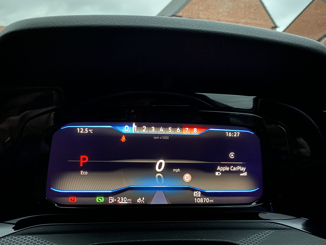

Really want the map on my dash ,but got absolutely no idea what I’m doing.
Although while messing around I have enabled a new display that I didn’t have before :smiley:
Offline bjbanny
  • Posts: 95
Re: SFD capability now added to OBD Eleven app
« Reply #23 on: 14 November 2021, 19:52 »
thats a nice find. it's the Golf R display.

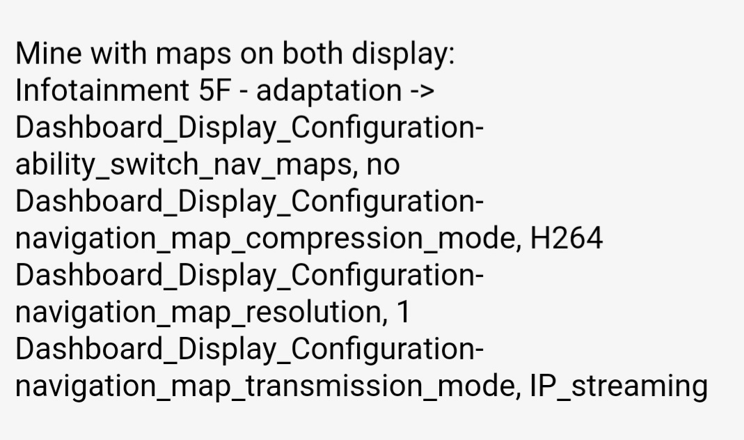

This is how I changed things to get the maps on the dash, used obd eleven and an iPhone.
Turn off sfd for the 5F unit first
To activate and to view maps on cluster ,you go into adaptions on the 5F control unit and under dashboard display configuration the settings should be as followed…
Navigation map transmission mode - IP Streaming
Navigation map compression mode - H264
Navigation map resolution - 1
Crossroad detail map transmission mode - Off
Crossroad detail map resolution - 0
Cover art - Bap
Station art - Bap
Call Picture - Bap
Dynamic icon -off
Ability switch nav maps - No
Make sure hood is open when writing to car
Once complete you should now have map cluster option on map (bottom left circle with 3 lines) may be greyed out at first and unable to select but do the below if you have this issue.
*you may need to reset infotainment system after by long pressing on/off button for 20 seconds to reset infotainment system.
