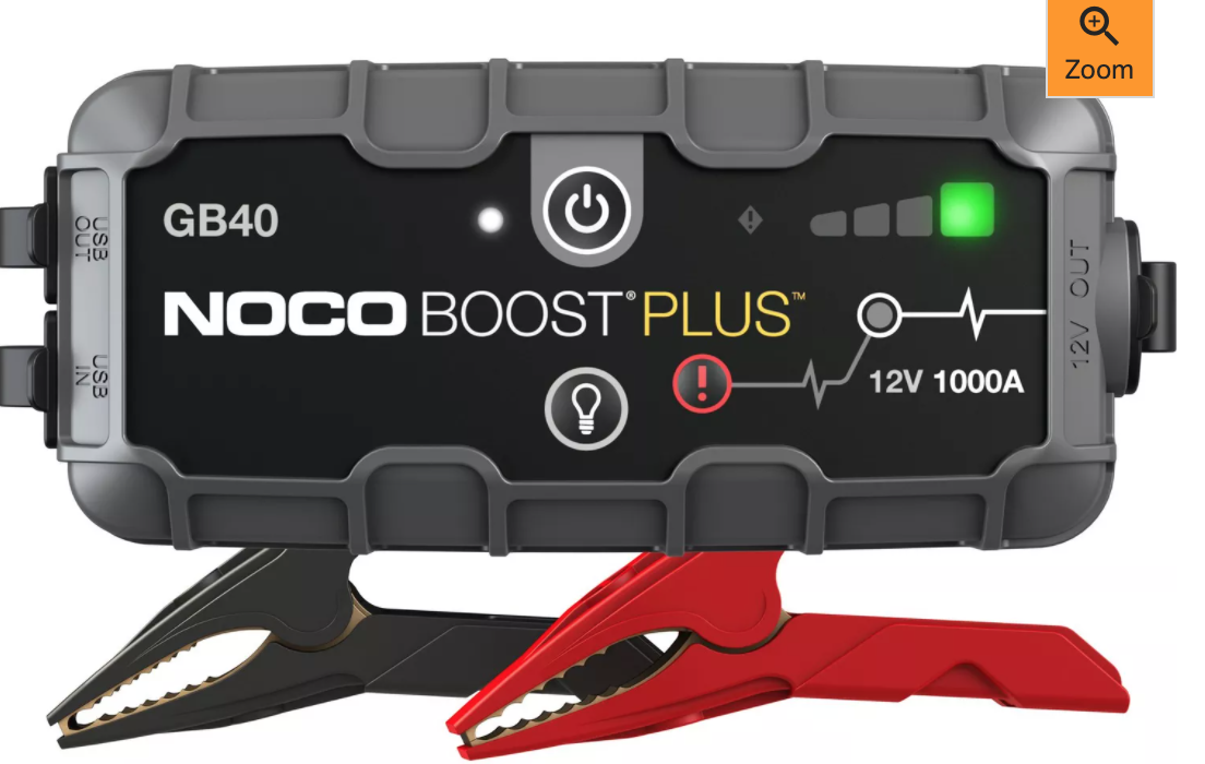

Just be prepared for it not to start suddenly and keep a jump starter handy as when mine went it only gave a days warning then absolutely nothing. :sad:
I've a wee jump pack similar to this one it's brilliant, I had to use it last night as my mk5 battery is dead as well despite being on a trickle charger. I've used it on lots of things up to a 4L V8 diesel and a 4L V8 petrol, much handier than jump leads.
https://www.halfords.com/motoring/battery-maintenance/jump-starters/gb40-1000a-noco-jump-starter-721898.html?cm_mmc=Google+PLA-_-Motoring%3EBattery+Maintenance%3EJump+Starters-_-Motoring%3EBattery+Maintenance%3EJump+Starters-_-721898&istCompanyId=b8708c57-7a02-4cf6-b2c0-dc36b54a327e&istFeedId=62b447cf-331e-4fec-a47a-9985ff72d404&istItemId=wrpxpiawq&istBid=t&_$ja=tsid:|cid:13230549599|agid:129538708744|tid:pla-329023466328|crid:523555172092|nw:u|rnd:15058221895568230635|dvc:c|adp:|mt:|loc:9045197&gclid=CjwKCAjw5c6LBhBdEiwAP9ejG3tXbdpAAPCxbD9Y6euXrwy-G13eyVVjy1J5pZlEACmrzwTCbqdMmxoCR-gQAvD_BwE
Offline Guzzle
  • Posts: 2,061
Re: Low Battery Car dead!
« Reply #6 on: 23 October 2021, 10:21 »
A mate of mine let me borrow his Halfords jump pack when my GTD battery was on its way out.
Brilliant bit of kit, saved me anyway. Think he said it was about £80. He uses it on his classic cars so definitely had his moneys worth.
