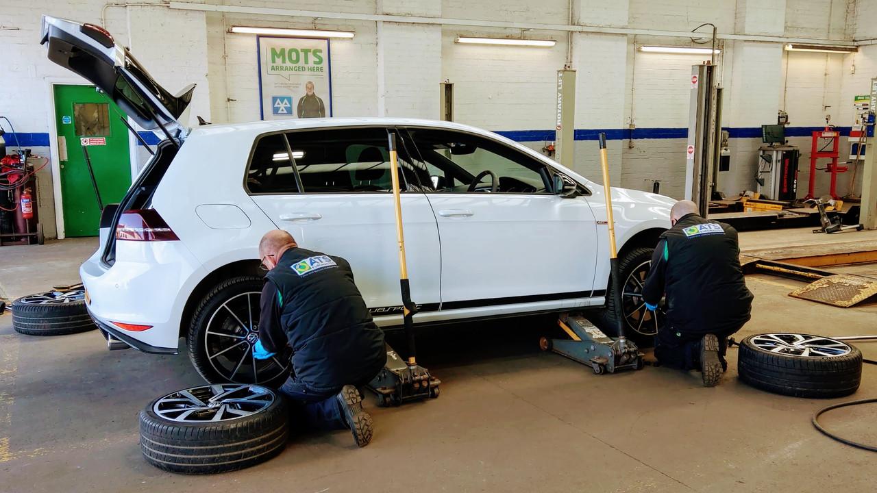

Using the correct jacking points, has anyone used 2 trolley jacks to jack up one side of their car to swop wheels front to back?  Is a car able to stand the stress of doing that?  Thanks.

It's stiff enough that if you place the jack at the front jacking point, it will lift both wheels on that side, assuming the jack goes high enough.
You could always place the spare on briefly, and then move the jack to the back jacking point or vice versa.

It is less stress on the chassis to lift up one side via two jacks than to lift up one corner via one jack, as it doesn't twist the chassis.
