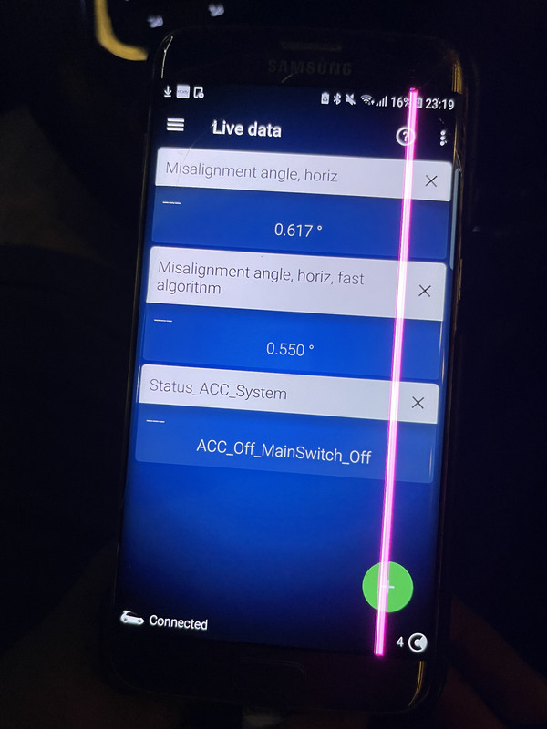

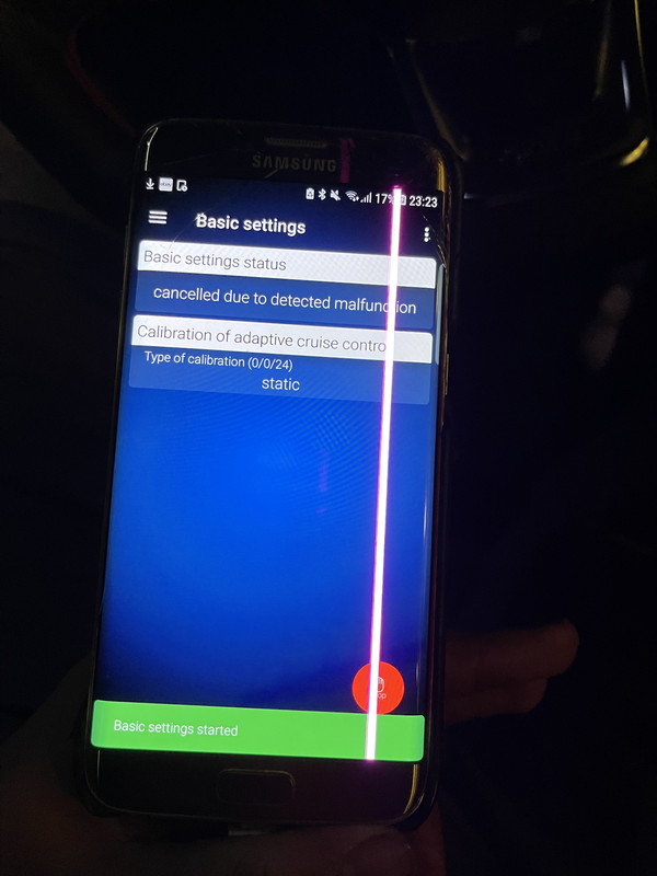

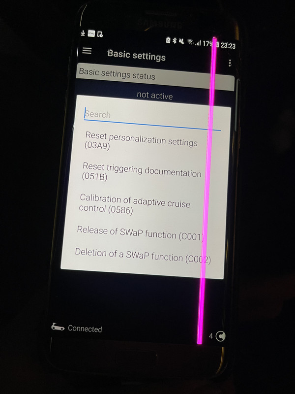

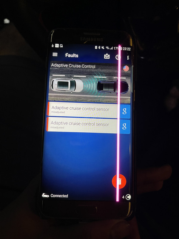

So update, I scanned with OBD11 and here is what it says.
There doesn’t seem to be any option to reset the misalignment angle in my basic settings for control module 13. Would I need VCDS?
