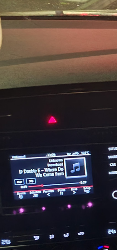

I can 2nd VW Retrofit.
I've got a 2014 GTD which come with mib1. Had Alex fit a mib2.5 unit with 8" screen for £850 back in May.
Unit works great haven't had any issues. DAB, nav, android auto/apple car play all work.
Retrofit took just over an hour.
Would definitely recommend!
