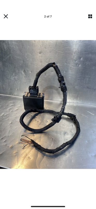

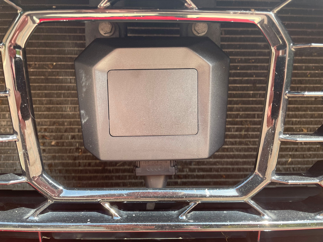

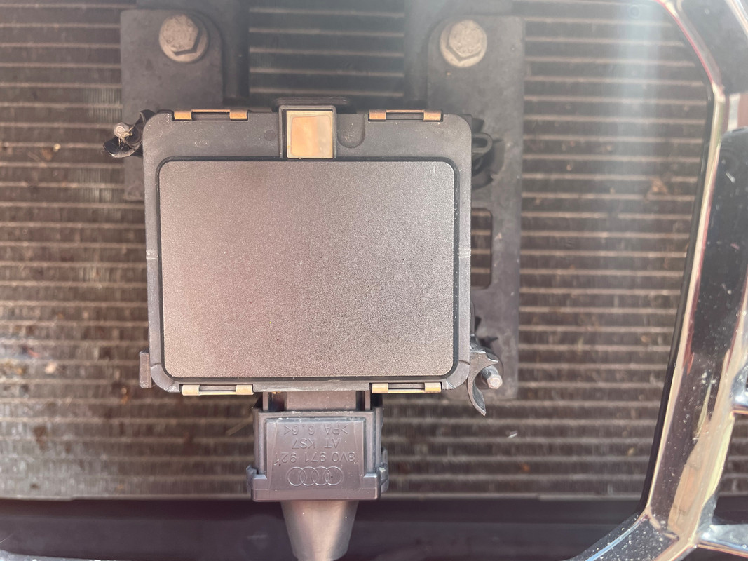

Hello all, just come back to a Golf after a year gap. Just bought a mk7 GTi CS, but would seem it has some hidden issues!!  So after some assistance please. Looks like the ACC module is incorrect and i suspect from another car. The original loom wire to the ACC is 6 wires, but a badly connected 4 wire(leaving 2 wires loose) has been connected to the original loom to connect to the incorrect ACC module?
Of course ACC inoperative.
Looking to purchase back an ACC module and find the correct,6 wire loom connector.
What module part number would a 2016 Golf GTi CS have?
I would image i need it aligning, but thats another day after sourcing the parts.
Thanks.

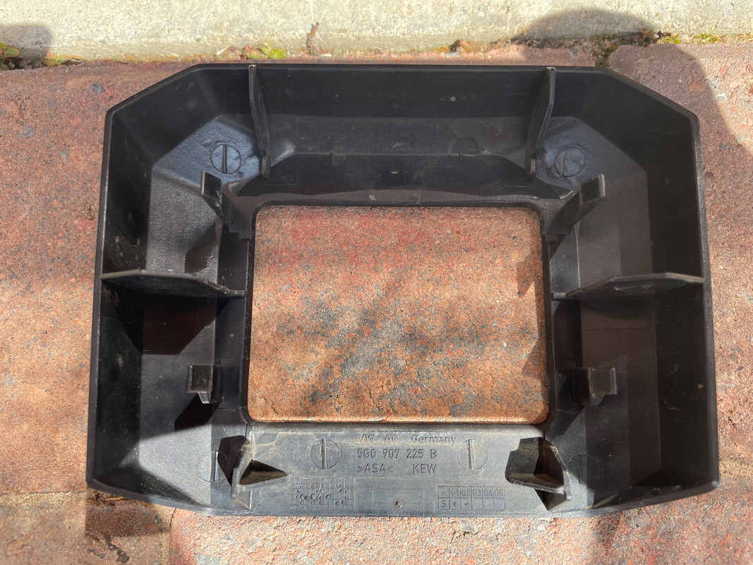

I could of course also be missing the cage to hold the unit??

I did yes.   It didn’t look like this the wire. It was all neat & tidy. I didn’t check cruise though on inspection.

From memory a brand new acc unit is about £800, that's what I was told when mine got mullered by a pheasant. This may have been for the sensor, fitting and calibration as the actual sensor doesn't appear that expensive. And yes the surround is missing to which is coppers to buy in comparison.

Hi there,
Mine looks just like yours, and its the original as fitted at the factory.
2017 CS ED40.

Thank you. That interesting, so the plug to the ACC is correct?  Wonder why hacked about and why the loom has 6 wires, but only 4 coming out of that plug??
5Q0907561H seems to have 6 wires.
 3Q0907571C seems to have 4 wires
I am removing the bumper again on Tuesday as i have an adaptive light issue, which i will start a separate thread for and check the part number & see if VW knows which one i should have?
Thanks for all the support.
