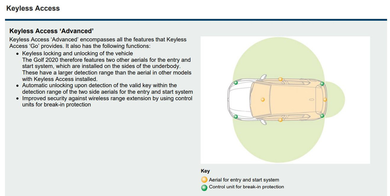

Let me explain how it works on the Mk8.... here is a slide from the VW self study guide on the Mk8:
What are the mysterious green things that offer "break-in protection"??
Well they are Ultra Wide Band (UWB) sensors. Your key also has UWB.
There are no low tech motion sensors in your MK8's key. That is old skool basic security, this is much more!
What UWB does is to provide highly accurate, tamper hardended range detection.
It means that the car knows where the key is - down to about 10cm. If the key is not present in those green zones, it will not work.

Firstly look back at the picture I pasted, it is possible your key location in your house could be inside of the green zone. Be careful!

Possibly the detection zone for approach (ie lights on) might be further than unlock. It certainly has the technical capability of detecting the exact location of the key over quite some distance.
