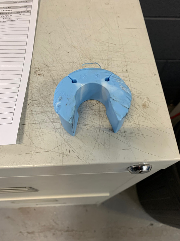

Happened to my 2013 GTD. The pucks are (or were) pink or blue (depending on thickness) and look like a plastic Pac Man. Jack the affected corner up (so the wheel is hanging on its own weight. Slip the rubber sheath up the suspension strut and feel up . Hopefully there's nothing there to the white plastic bump stop. If there is, removed the puck and get your car booked in for a new suspension top mount bearing as the puck will have smashed it up.
FYI, there are no pucks on the rear suspension.

Following a horrible drive back to the dealership this morning......there were x2 'pucks' still on the shaft of the shock absorber.
The manager was amazed at how this could have happened. I got a free tank of fuel and many apologies.
The strange thing being that the person who did the PDI had removed all three from the passenger side and only one from the drivers side.

I would still get that top mount bearing changed - it will have taken a battering.
