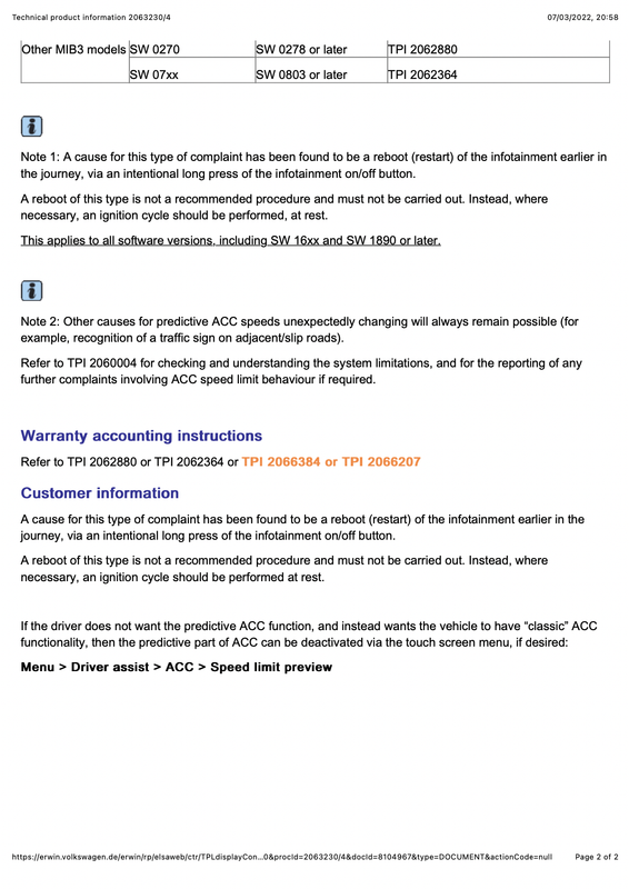

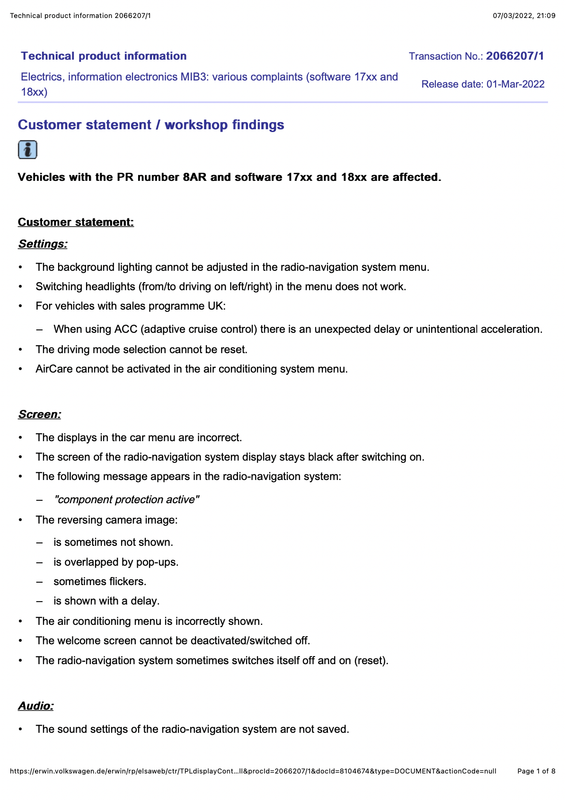

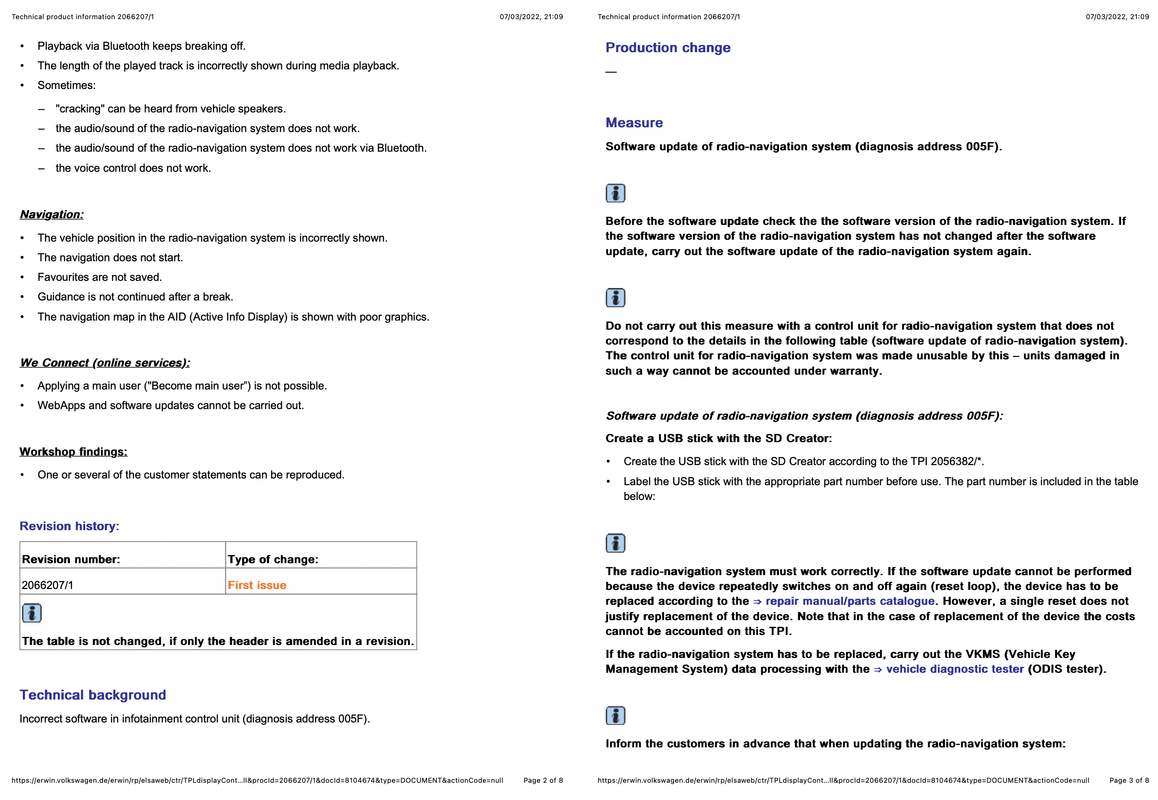

Some TPI updates under reference 2063230/4 about 17** and 18** software upgrades - there is now an updated 1896 version to replace the earlier 1890.
No news yet for those on 16** versions.

So what's this meant to fix over the 1890
Offline fredgroves
  • Posts: 8,053
Re: Mk8 software version poll
« Reply #468 on: 08 March 2022, 09:53 »
Its in the TPI!
