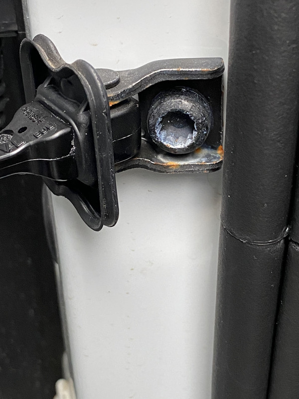

Issue: Corroding Front Door Straps
Notice that front black door straps had spots of rust appearing on them.  Didn't expect that from a new car.  Not at this age.  Don't think my Mk6 ones had this problem at all.
Obviously concerned that this would get worse and impact the paint behind the door strap.
To me looks like the factory have been rather cheap on the amount of paint applied.  :rolleyes:
Fix:  OSF and NSF door straps replaced under warranty.
