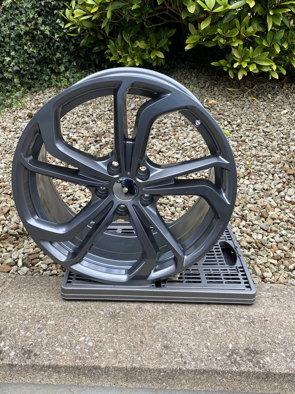

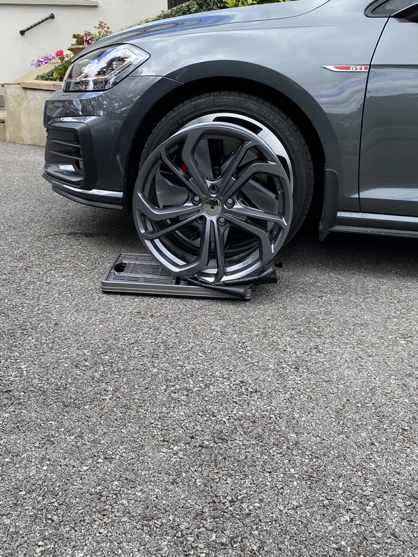

Update  I have now bought a set of 18” Reifnitz in satin gunmetal which I collected from CM wheels today. Please see the pictures below to get an idea of how they look with Indium Grey. They still need to be protected/coated, shod and balanced so they will not be on right away. I also looked at a set of matt gun metal 18” replica Pretorias which were striking but not for me. They tell me this is the first batch they have had of the gunmetal Pret.

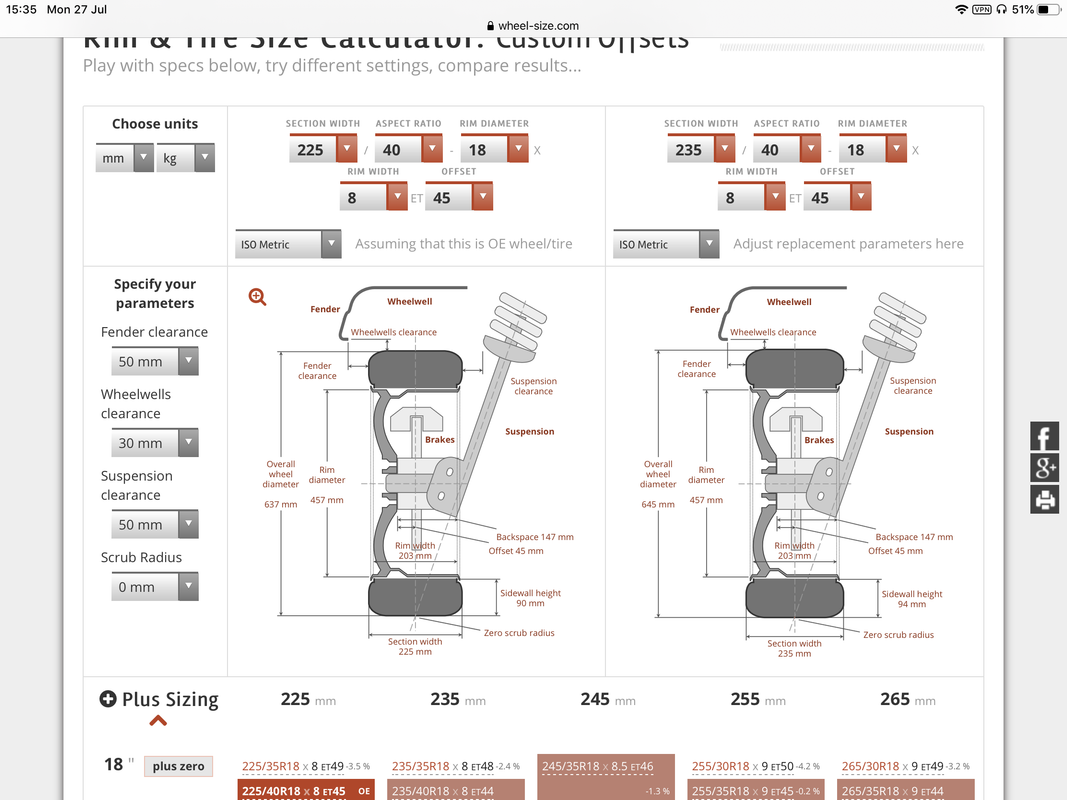

Looking at tyres. Could swap the current Potenza S100s on to the Reifnitz. I have looked at 235 v 225 on some wheel/tyre comparison sites. Seems to be little difference. I accept the width is 8mm up and the sites show me the 235s are 4mm higher on the side wall but there seems to be no other difference in any of the other measurements. I have given the correct offset for the rims. Has anyone made this change and if so have there been benefits or problems? I have looked at the sites suggested in other posts from a previous thread by McMaddy and others and currently  I am thinking of Goodyear F1 Assymetric 5s. 225 X 40 X18 are around £315 and 235 are around £400. Thoughts please.

More rubber, more unsprung weight. More unsprung weight makes the car less pointy.
Looking at it like that, 225 sounds sensible no?

I tend to agree with you. Small performance/aesthetic margins, more weight.  I think I read somewhere the weight difference between the 225 and 235s are a couple of kilos per tyre. Also slight increase in cost. If you are relying on 8 - 10mm for more grip, you’re going/cornering too fast. I think I might be agonising over not much.  :huh: The rims are 8J and both 225 and 235 are cited as optimal for this width of rim.
