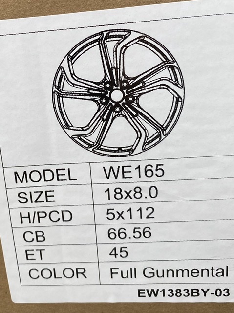

How much does the rep Reifnitz weigh?
Hi I looked at the box of the wheel which gives some info about them but not the weight.  Currently I have them in a lock up but will go and weigh one in the next few days. They don’t seem too heavy to me from my memory of the weight of the Santiagos and Miltons but it will be interesting.
Hi I looked at the box of the wheel which gives some info about them but not the weight (see below).  Currently I have them in a lock up but will go and weigh one in the next few days. They don’t seem too heavy to me from my memory of the weight of the Santiagos and Miltons but it will be interesting.
I take it they've given you spigot rings? Centre bore is 57.1 and yours say 66.56.

« Reply #36 on: 11 July 2020, 08:34 »
Yes, CM raised it and they literally threw them in (to the box).  :smiley:

« Reply #38 on: 12 July 2020, 11:08 »
In prep for fitting, any experience or preference for plastic or aluminium alloy spigot rings? Has anyone had a good or bad experience? I was given plastic and wonder if alloy might be better. I have done some reading and it seems both are widely used and are available in the size I need, 66.6 to 57.1.
« Last Edit: 12 July 2020, 11:15 by Ceefeesh »
Offline SRGTD
  • Posts: 3,969
Re: Wheel choice
« Reply #39 on: 12 July 2020, 11:52 »
I’d use the plastic ones that’ve been supplied. I’ve read that the alloy ones can corrode onto the hubs  whereas this won’t happen with the plastic ones.
