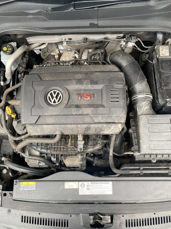

Noticed a coolant leak on my Mk7.5 at c70K miles. Coolant light was coming on around every two weeks.
 < Got the leak diagnosed for £100 from an independent in NW London (Finchley VW quoted £250) for diagnostics. Problem was as expected - leak from water pump / thermostat housing.
> Independent changed water pump and thermostat housing for £1190 inc VAT. Thought this was quite pricey but labour rates down in London are higher than up north. Parts were c£450 of the total cost. Bit the bullet and got it fixed. Did a long drive up to the lakes and back last week and all good so far.
> Independent changed water pump and thermostat housing for £1190 inc VAT. Thought this was quite pricey but labour rates down in London are higher than up north. Parts were c£450 of t)he total cost. Bit the bullet and got it fixed. Did a long drive up to the lakes and back last week and all good so far.
I know that the MK7 R's have a known issue with the waterpumps and Thermos and even when you get it sorted, it is only a matter of time before it goes again. Main reason I wouldn't entertain a MK7 R and went for the Ed35.
Would it be the same for GTi's too?
