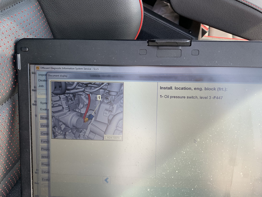

Diagnosed and the fault found...
A faulty oil pressure switch. This engine apparently has 3 oil switches, and the one that’s failed is the one not carried on the VW technician’s van.
I’ve been recovered back to my dealer and whilst on route they rang through to the dealer to make sure I have a replacement car to jump into the other end.
To be fair to VW, great service all round so far, just a shame it’s ruined the day.  :sad:
