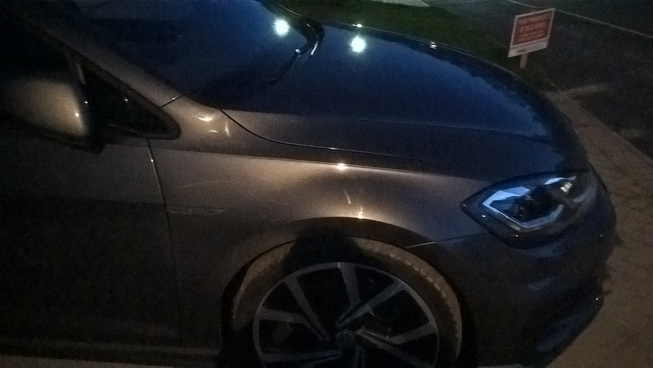

I recently suffered a park car ding when someone reversed into the front drivers corner of my bumper as I was sat waiting for a space. There was not much damage. The swage line off the arch was scuffed as well as the fog light surround and a little paint was taken off above it. Off it went through the insurance to get repaired. When it has come back I am devastated. The whole car seems to have a layer of overspray on it but worse is the fact that the wing has been polished into the bonnet and door leaving obvious swirl marks that you can see is direct sunlight and under street lighting. I would not have expected all the wing to be polished considering the repair was on the bumper. My wife has complained but they seemed to dismiss her complaint she she pushed it and they now concede that the car is covered in overspray. They have said that they can apply a coat of ‘blue gel’ to remove the overspray but then they will have to ‘machine it’. They have also said that a coat of wax would remove the swirl marks on the wing but they do not apply wax. My wife pushed again because if they machine the whole car then it will all have swirl marks. They have said they will send the car to a local valet firm to wax it after they have machined it.
I do not want them to touch the car any further. Any advice would be welcome.
The photo shows the wing but it is not the best as it was taken in the dark.

The photo shows buffer trails left from the polishing process. Applying wax WILL NOT remove these, it may mask them slightly but the only way to remove buffer trails is to have the car machine polished again by someone more skilled. They are relatively easy to remove in the hands of someone who knows how to polish.  The overspray can be removed by claying and machine polishing.  I would push for the overspray and buffer trails to be remedied by a professional detailer.  A “local valet firm” would not assure me at all.  I would find a reputable detailer or two, enquire as to their costs to rectify and then present the quotes to the insurance company and push to have that course of action and the costs met.

If the body shop didn’t remove the front bumper when they repainted the damaged area, it’s possible that they may have blended the new paintwork on the bumper into the wing and then machine polished the bumper and wing. That would explain why you’ve got buffer trails (rather than swirls) on the paintwork on the wing.
Although I’ve not tried it, it should be possible to remove paint overspray by claying the affected area(s). There’s lots of videos on YouTube to show how this works. Claying might inflict some marring to the paintwork if insufficient lubricant is used, especially if a heavy grade clay bar is (or needs to be) used to remove paint overspray. However, marring can be removed by machine polishing, using an appropriate combination of polish and pad - a good professional detailer should be able to rectify your paintwork issues without any problems; but at a cost, and you shouldn’t have to bear the cost of putting right the damage the body shop has caused.
