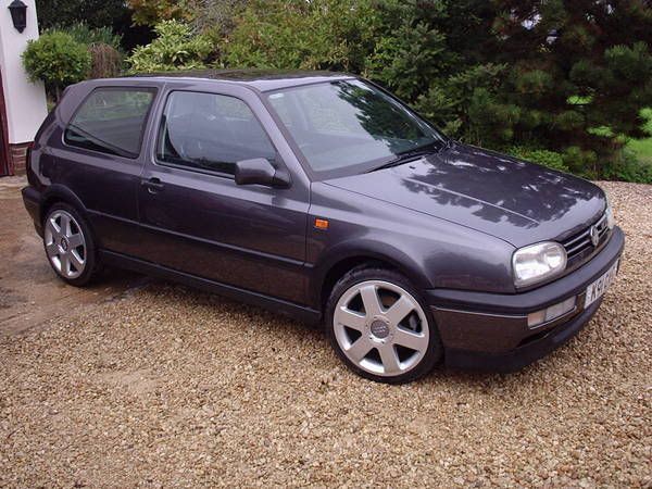

This is what I want.   My VR6 is the black 3 door also.  Sadly the guy who owns it doesn't exist on the forum any-more / hasent owned the car for a decade.
......So I copied the wheels. (Or so I think I did.)
I am happy to lower it a bit but felt getting the wheels on first and seeing what I had to play with was the first thing to do?  Is that right mate?
What tyres do you think they are.

225/45/17 that come on those wheels are way out. 205/40/17's are the right size for the mk3. They rears might catch the arches ever so slightly - I did the same back in 1999  :smiley:
