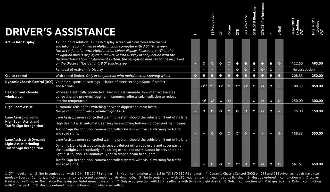

If it doesn't have Assist/Camera/Keyless then it's a MY18 car, and sadly Dynamic Light Assist was an option. Here's the MY18 brochure page (bottom row) which gives detail of what was included in the option...
It is that option which is now standard on the MY19 Performance.
