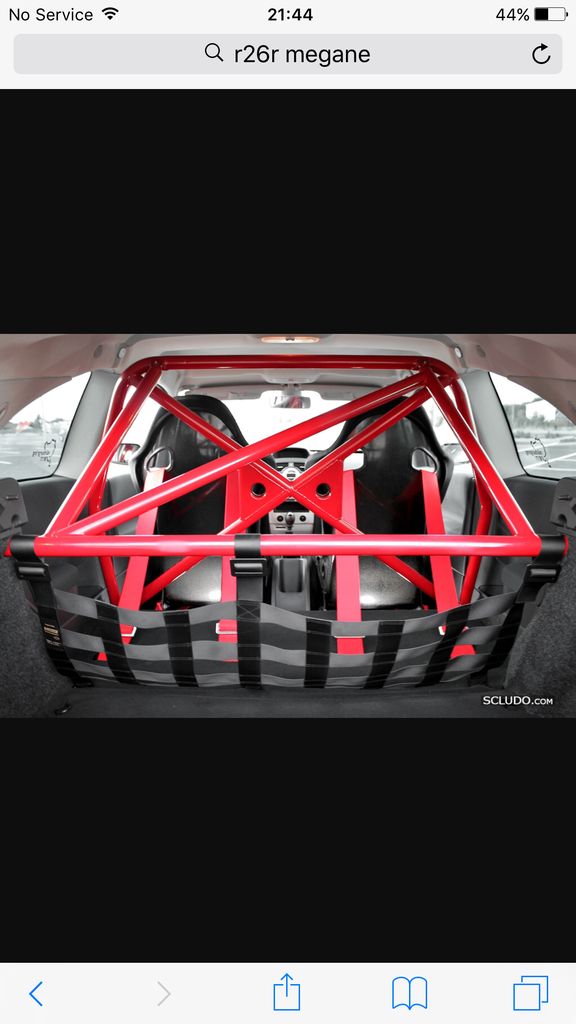

I think it is a lot to do with whether the seat is up to the job and if the harness holes are functional
Are the seats made by VW or does someone know how to find out?
I looked at pics of the Renault R26r which came from the factory with a cage and harnesses though the seats were proper buckets so this is the issue confirmed i'd say (see pic)

Notice how renault didn't even use the horizontal bar that lends itself to being a harness bar

In rallying they tend to attach the shoulder straps low down and usually to the rear of the cage. The hole idea behind having them low down is to keep you pinned down into the seat during a roll.

The biggest issue I can see is that all the TUV approval and crash tests would have been done with standard seatbelts, not harnesses.
From what I can gather, the problems occour when you add non standard items (IE a harness) to a seat that we are unsure of actually being designed (despite the slots in the seat) to use. I also can't see any way that VW would have tested the seats with harnesses (due to the multitude of variables involved when aftermarket parts are fitted). I just think it's not worth the risk to take that chance of using harnesses on standard seats without a good amount of research/checking.
Sorry for appearing to pee on the OPs bonfire but I'd rather mention it than not and then something happen.

@ Viper If the harness holes are too low and the belts really do sit on your shoulders from that angle, won't you potentially suffer compression in the hopefully unlikely event of a crash? Perhaps LRW can help with this as I guess he must have some regulations for racing?
This is from the MSA BlueBook (2015 as it is to hand).
(K) 2.1.10
The anchorage points to the rear should be positioned so that the strap from the shoulder is near horizontal as possible. It should not be located on the floor directly behind the drover/co-driver.
My own two pence worth:
I think that the harness are safe mounted to the cage. Its a shame the cargo-net bar thing isn't up to the job as a harness bar. I'm not 100% sure how it is mounted but it looks like it uses the rear seat mounts some how?
I would like to assume that reputable manufacturers  (Recaro, Sparco OMP et al) would not cut harness slots in a road based seat for purely aesthetic reasons and would perform some testing with correctly mounted harnesses.
