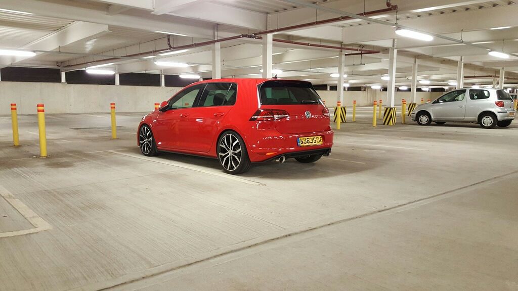

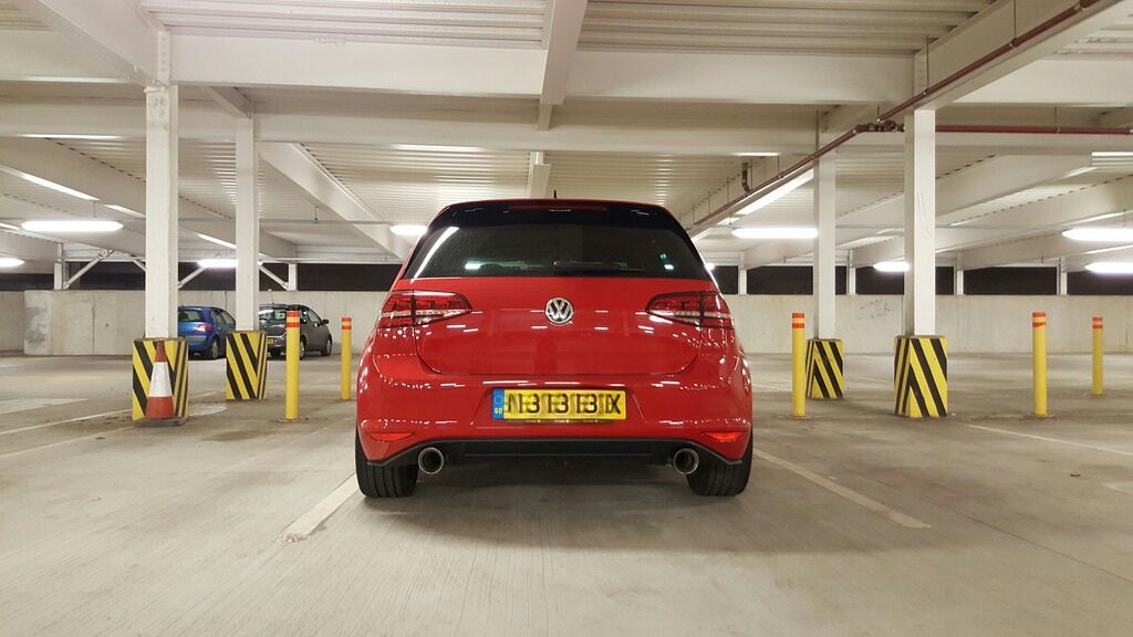

I have 20mm spacers on the rear with my santiagos and no rubbing or issues. 12mm on the front and they do rub slightly as I need to do the fender bolt mod.
Spacers are H&R Traks

Hi that looks great, I live in teesside if you are close could I take a look? and is that lowered?
Cheers, I'm driving down that way saturday like, yeah VWR springs - great ride with them, handling improved a little bit as well - although i'm itching to switch to coilovers...
Also spacers were ordered from DPM Performance - good service and fast delivery.
