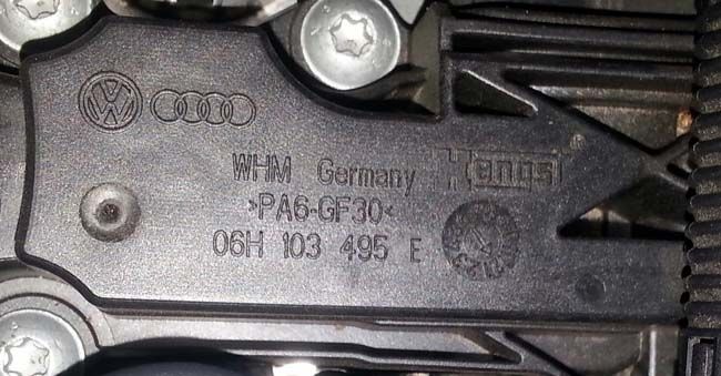

Ordered a new PCV valve 06H 103 495 AD (£78.20) and breather pipe 06J 103 213 E (£22.40) which it's advised to change as well due to the likelihood of broken tabs https://www.youtube.com/watch?v=hQEciqR1ST8. Next day delivery so will be able to fit them tomorrow.
Asked about buying this today from VW dealer for my early 2010 model. Oddly being told mine would be a 06H 103 495 D for a new one and the car would be fitted with a A version from the factory.
 When I looked at the one on the car it was version E.
Haven't ordered yet as bit confused.  :sad:

ETKA still not working for me mate I'm afraid otherwise I'd be on this! All I can say is that when mine went in April I checked it and the my replacement was the latest version (06H 103 495 AD).

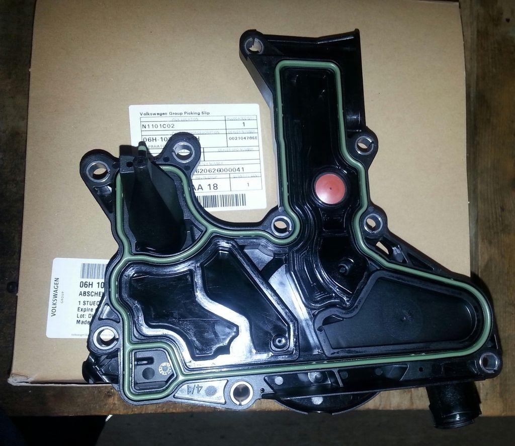

Just got the part.
One I recieved is 06H 103 495 AH
Date stamped 3/16
Will fit it at the weekend

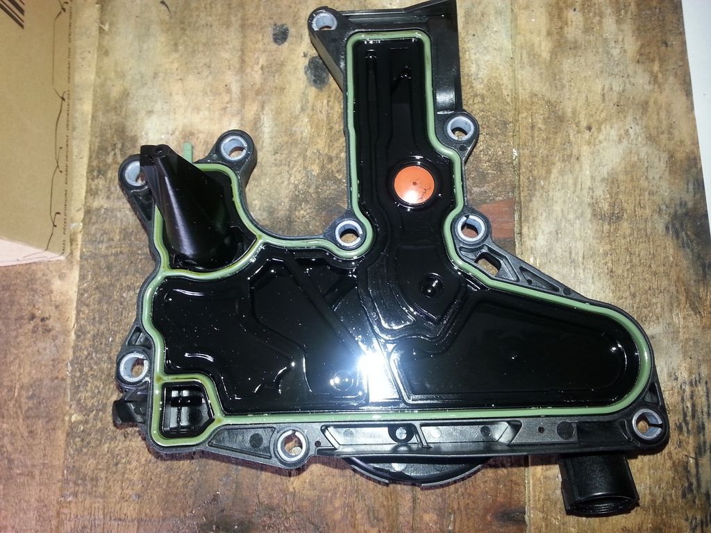

Your photo of AD
My AH version
« Last Edit: 07 October 2016, 16:22 by Snoopy »

Offline Snoopy
  • Moderator
  • Posts: 7,795
  • Geoff.
Re: ETKA check please
« Reply #5 on: 07 October 2016, 16:24 »
Hum mine doesn't have the extra valve and white plastic guide yours does.
« Last Edit: 07 October 2016, 16:42 by Snoopy »

Offline seabrook132
  • Posts: 580
« Reply #6 on: 07 October 2016, 20:24 »
Yeah, that's odd. Be interesting to see what your old valve looks like.

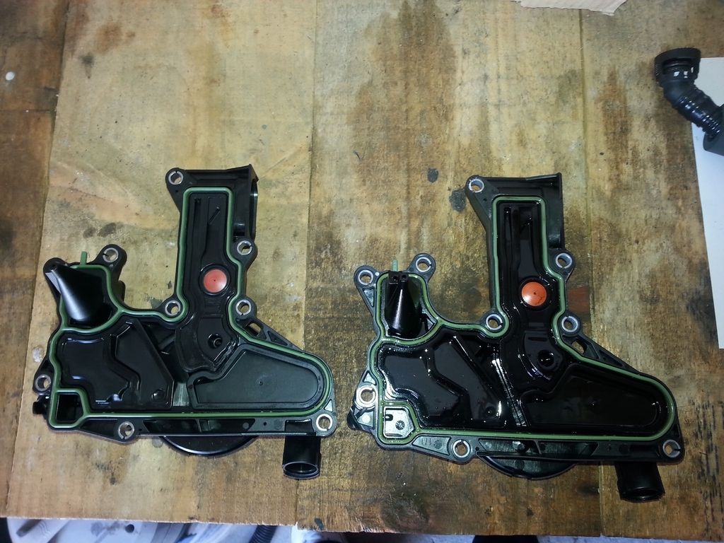

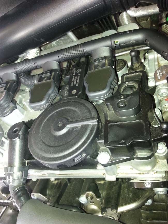

PCV
« Reply #7 on: 08 October 2016, 14:32 »
Removal
Old E version
New AH version on the left, old E version on the right.
« Last Edit: 08 October 2016, 14:42 by Snoopy »

« Reply #9 on: 12 October 2016, 21:42 »
H
Fitted them both after lunch, nice and easy to change. Car is now unhappy to idle with the dipstick quickly pulled out while running, indicating new PCV valve is working. Leaks cleaned up and I'll monitor them over the rest of the week and weekend.
Im actually more concerned now about mine with the new one fitted as it seems to make little to no difference removing the dipstick.
