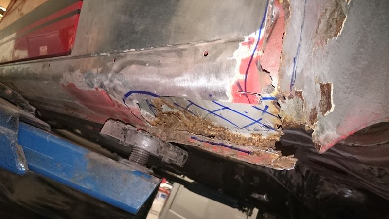

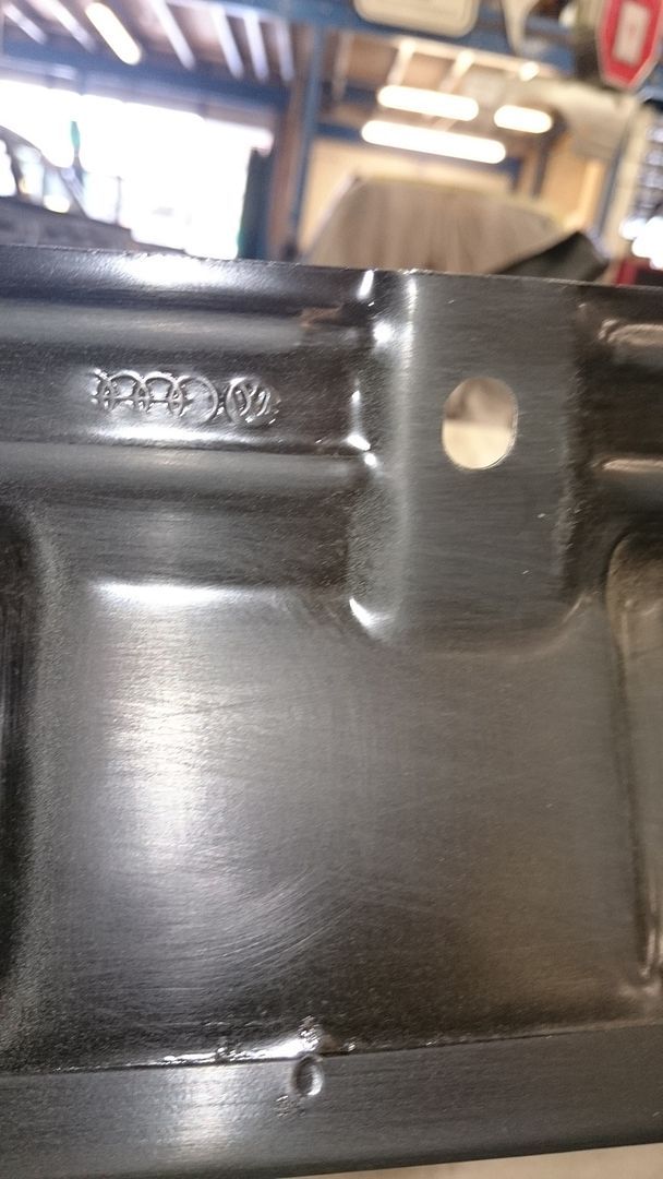

Hey guys this is my build, I will let the picture do the talking. (some pics are not in order but you get the idea)

Cut bit of the rot see the inner sill.

Cut a bit of rot on rear wheel tub

Cut the rot out time*:lol:Mark out the rot area and cut
Not as bad as I thought

Door was all finished and applied Slick Sand
last bit of welding on both arch's
move the car across the workshop
Attacked the back panel
rather change the whole panel just the area that was rotten.
With all the welding done and light filer work so time for some slick sand on the body!
All the Slick sand blocked down time for tinted primer.
Time to block the primer down.
