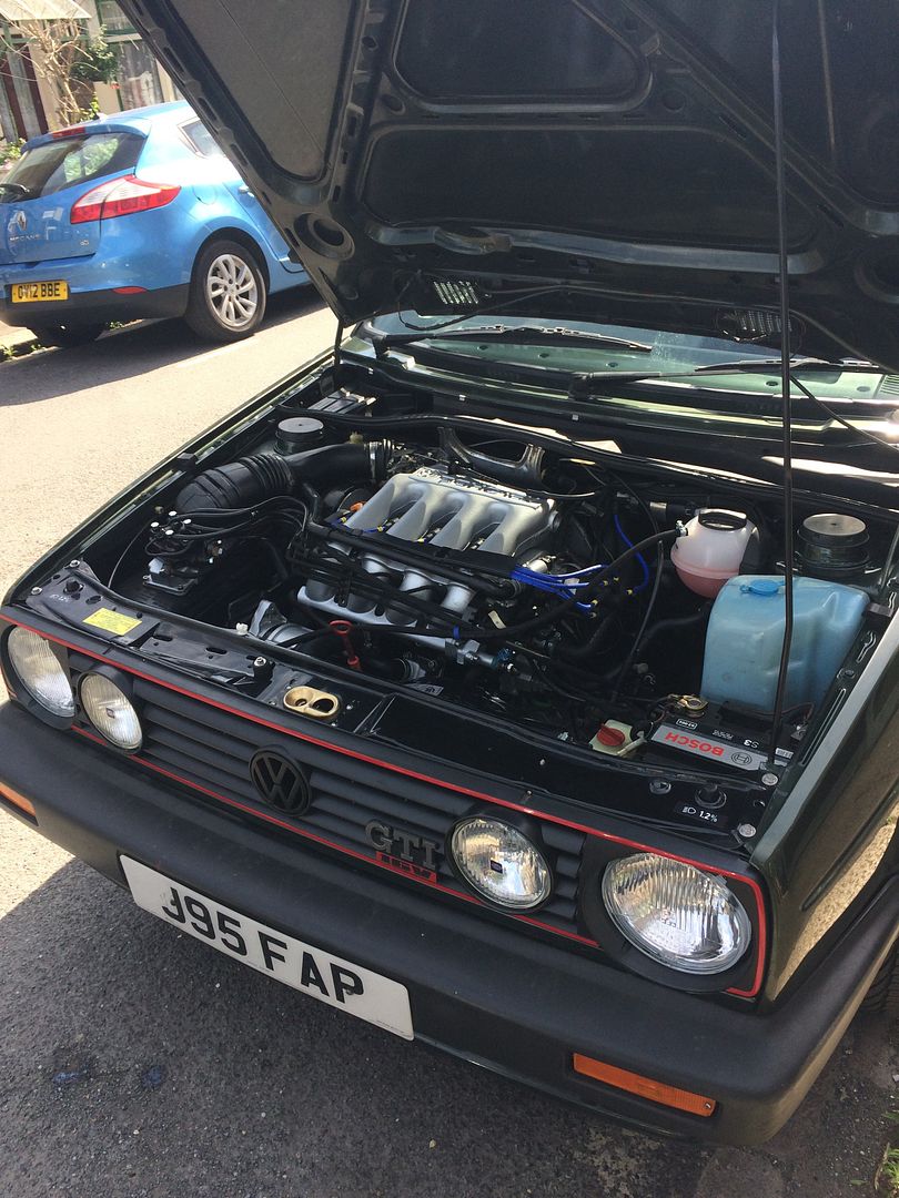

Hi ,
I had the car ticking over today thinking it sounded ok but was informed that it didn't sound right.
The guy then pulled the plug on cylinder 1,. no change to the running, but pull any other plug and it starts to run rough.
So have checked the injectors, and swapped them around checked the spark plugs and leads but nothing makes any difference.
There is no smoke from exhaust on start up or when running it also starts up very easy.
I know its going to need a compression test but has any one any ideas what might be going on?
