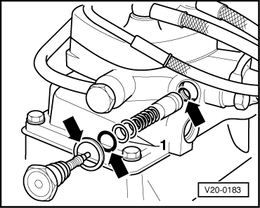

Could be the non-return valve (check valve) on the fuel pump. Also could be Fuel Pressure Regulator Valve in the metering head - the rubber O-rings perish and need replacing. Mine does exactly the same. Takes ages to starts after I've left it for 10-15 minutes after driving it. I've ordered some new O-rings for mine from a local company. VW don't stock them anymore.
Fuel Pressure Regulator:
