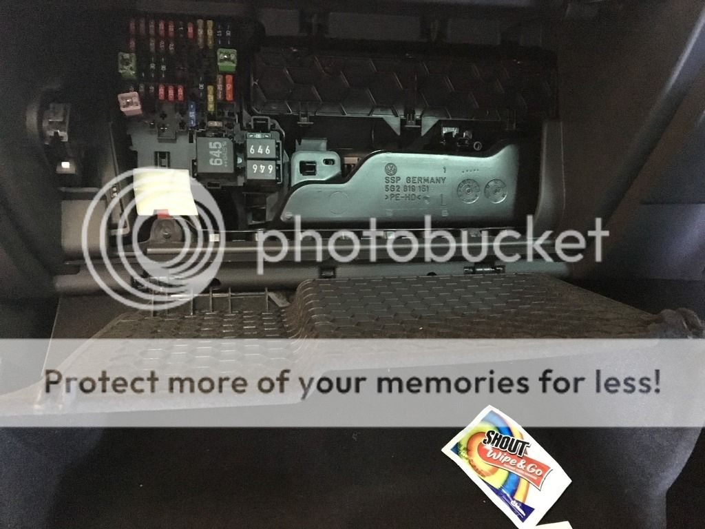

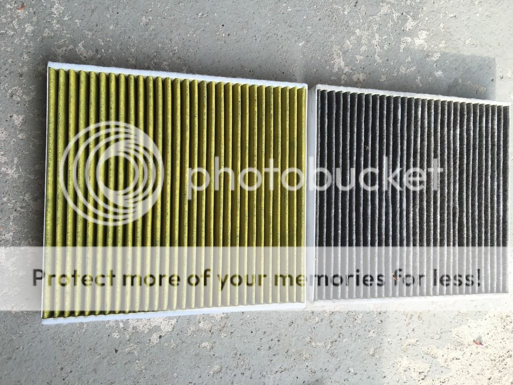

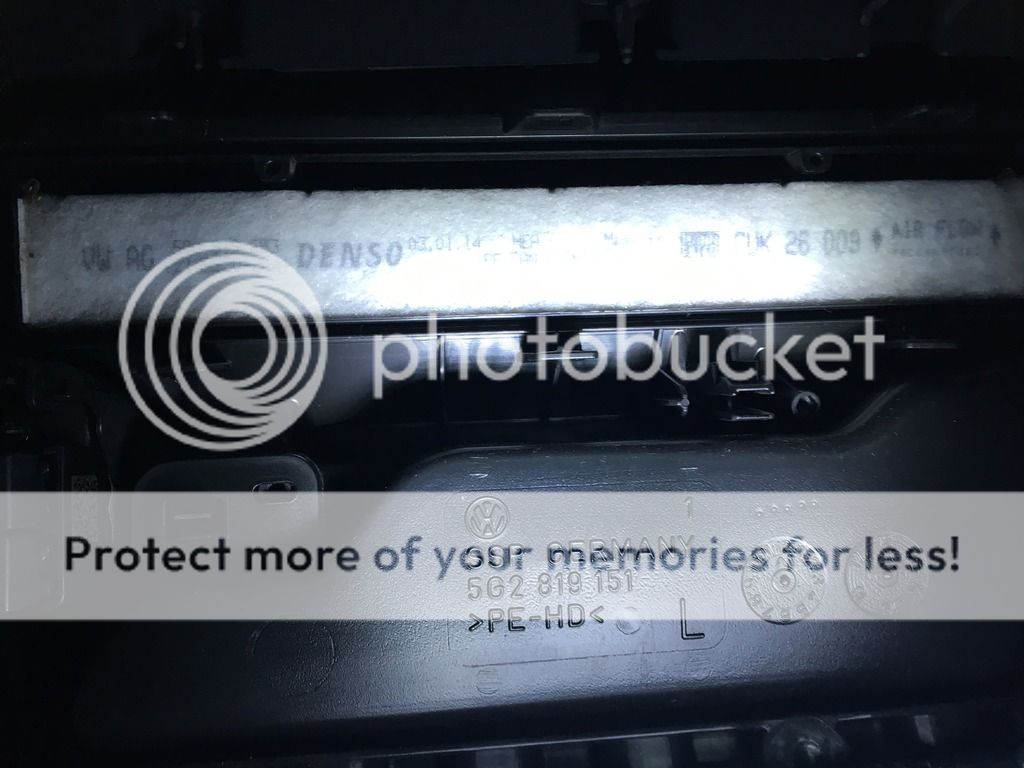

I can confirm that the Mann pollen filter FP 26 009 is the correct one, I've just fitted it - I'll get some photos loaded up shortly. I paid £22.46 from Amazon (£18.32 + £4.14 p+p) and it's a 5 minute job to swap it, albeit a bit fiddly.
I watched the following video for guidance https://m.youtube.com/watch?v=k_UGcsFfTuY

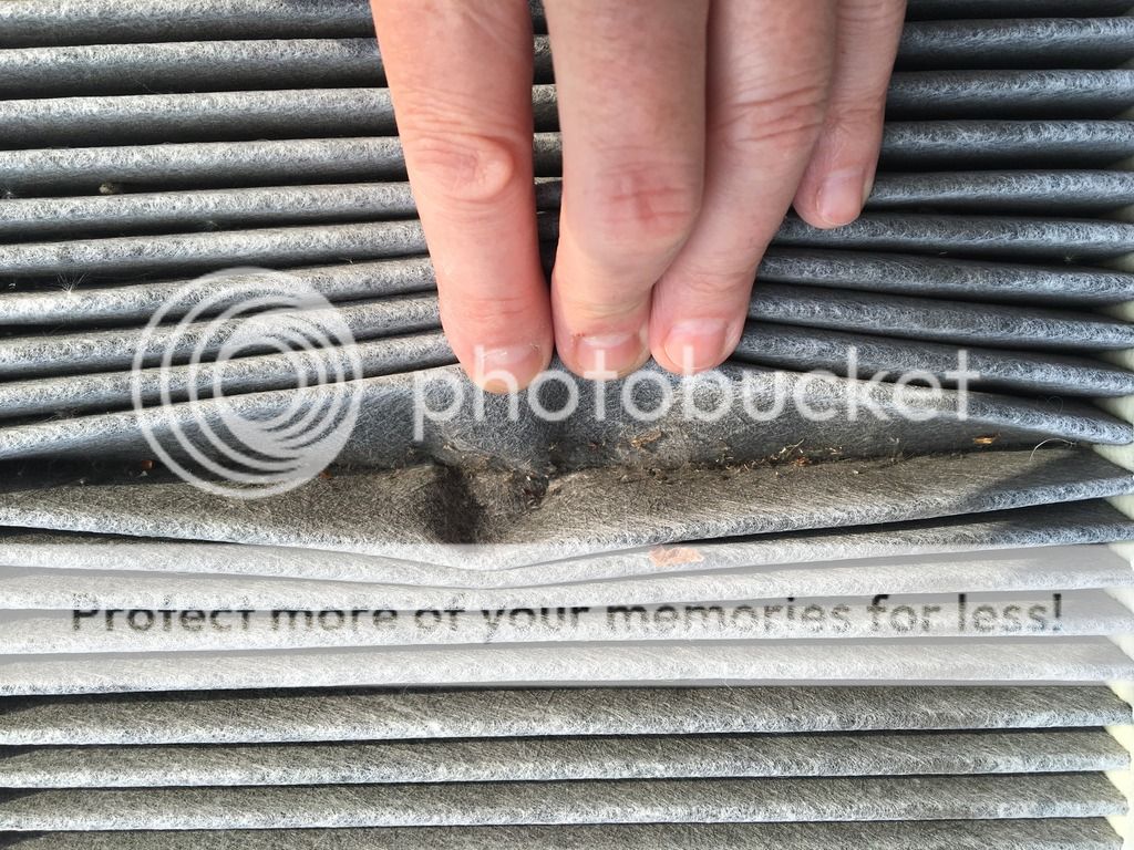

The old one is pretty mucky! How long, and how many miles, has it been in to get like that?
