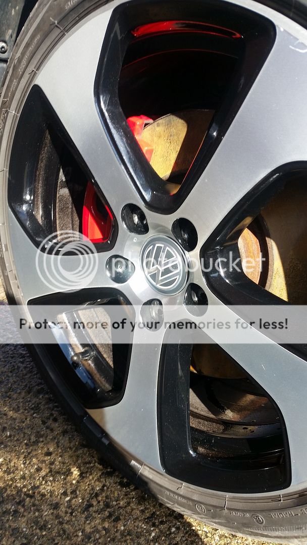

I wonder if any of our esteemed members can offer an opinion for me please, I washed my 14 plate new to me car today and the front N/S Austin wheel has brown deposits on the black paint on the inside of the wheel barrel and behind the spokes where they join the wheel rim.
I gave it all a squirt with some dragons breath and left it to dwell a bit and expected it to come off really,but it wont, ive tried some wonder wheels stuff as well and that wont shift it-its almost as if its rust coming through the paint?
Has anyone come across this before or anything similar,it doesnt look like the lady who owned it before me was into washing her wheels!
Any ideas what I could use to move it,obviously if it is rust ill have to go back and see what the dealer says.

The wheel probably looks worse in the pic than it does to the eye! Apart from the rust or fallout or whatever it is,I dont know how to resize the pic either sorry!

This is just iron build up / brake dust. :-) get a decent iron fallout remover like AutoBrite's Purple Rain 2.0, Iron-X or Auto Finesse IronOut and it will soon sort it. Just follow instructions and don't leave on for too long !!

I find claying the wheels is the only way to get rid of this completely.

IronOut from Autofinesse and leave it for 5 mins to action. Your wheels will turn purple as it disolves all the baked in brake dust and iron deposits from the rim. Then power wash them and apply some sealant like Gtecniq-C5.

The OP says he's used Dragons Breath on them already.
My bro had this on his santiagos and I, through a process of elimination, noted that it was due to a cheap wheel cleaner he was using.
I'd suggest taking the wheels off, claying, cleaning and sealing and then stick to just washing then more regularly.

As others have said it's a build up of brake dust. As they don't look like they've ever had much attention it will take a combined attack to remove all that iron deposit.  That said, it doesn't take that much build up of brake dust on black wheel barrels to look like that. I used to have similar wheels on my last car and it was amazing how much it showed and I was pretty anal about keeping them clean.
I know you've already used Dragon's Breath but you will need to give it at least another going over with that, possibly more. Then, as Neil (WoWo) suggests clay it to get any remaining stubborn iron deposits off.  Again you may need to clay it a couple of times.
Then once they are free from deposits, it's a case of maintaining that with regular cleans and use of a decent wheel cleaner like ValetPro Bilberry Wheel Cleaner diluted 1:10 with water, and using the Dragon's Breath 2-3 times a year, and applying a decent wheel sealant on a regular basis. Applying a good wheel sealant if the biggest favour you can do yourself, once they are clean and free from brake dust.  Look at something like Gtechniq C5 or Gyeon Q2 Rim Quartz sealant.  Application of this type of sealant is a wheels off jobbie but once done, it will repel brake dust very well and the majority of it will just fly off when you get the hose or jet washer on them.  Failing that any decent wheel sealant will help to protect them.

It'll be much easier if you remove the wheels and work it from behind.
