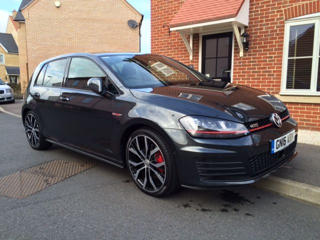

Hopefully this picture link will work!
This was after I first cleaned it, only took the 1 picture on my phone but will take some better ones when I next clean it.
