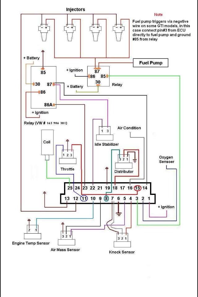

Hi - I have a golf 1.6 Clipper carb cabriolet which has a Corrado KR 1.8 16v engine fitted, I installed it myself. I'm in the motor trade.
My throttle body has 3 wires coming from it, and I need to have a full engine diagram please. Specifically I need help with the throttle body wiring. I need know which wires go where, ie engine cut off, vacuum switch, and idle speed control valve, cold start system, lives and earths. Also the fuel pump wiring is causing me problems.

Does this help?

Hi there sorry for delay I've been away. I think this diagram is for later engine, mine has no oxygen sensor and its mechanical injection jet tronic  I think, have you an early diagram for gti about 1991 it's KR engine 16 valve

Should find all you need here
http://www.clubgti.com/showthread.php?277245-KR-16v-K-jet-CE1-CE2-engine-control-wiring-scans-Corrado-Golf-2-19-1G-Passat-31
There's also a link to the infamous rub-jonny's wiring diagrams!

Wow, so helpful, many thanks indeed much appreciated. Regards steve
