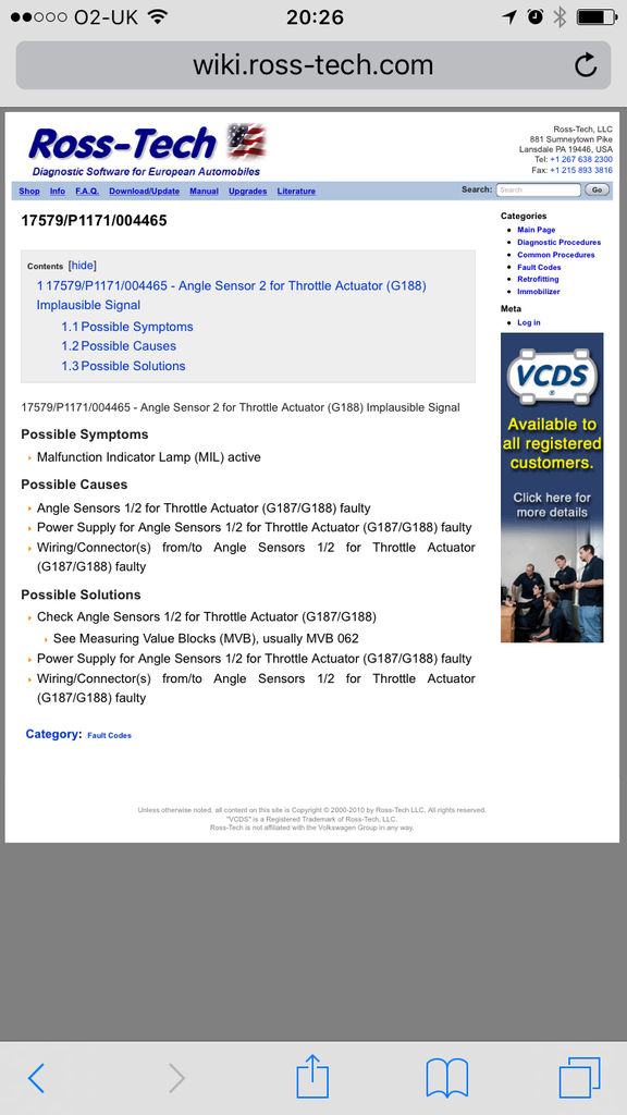

Have you had a play on here with that fault code?

Regarding VCDS, yeh I've looked the codes up on there. That's what prompted me to buy a new Throttle body.

P1559 on rosstec says do a throttle body adaption
