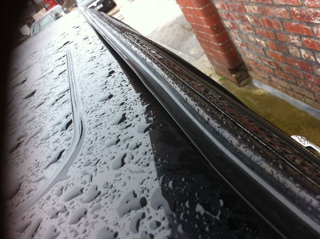

As further to the previous suggestion, I've rolled out the seatbelts and found that the front passenger seatbelt is indeed getting wet! Does this mean I need to be taking the roof lining out ((uuughhhhhhh)) and replacing the drainage pipes, or just checking to see if it is blocked? I'd have thought that if the pipe was cracked or something the roof lining would be wet too!... Aaaaaalso, as were on the subject, if the roof gutter trim isn't seated right up against the roof (will add a pic so you know what I mean) would this allow water in too?

Offline gazareth
  • Posts: 1,346
Re: Leaky doors
« Reply #8 on: 12 December 2015, 23:39 »
is the rubber strip not just a piece of trim to hide the spot welds between the roof and side panels? I am not sure as I have never had the courage to pull it off :grin:

« Reply #9 on: 18 January 2016, 21:55 »
So yeah, grew a pair and decided to pull back the gutter trim. Yes you were right it does just hide the welds. Turns out that some of the little white clips had broken on the underside so was causing it not to seat correctly. Have replaced since and now it sits nicely. I found the source of the leaks, it was the door skin/membrane that had failed. Sooo f***in annoying, spent 3 hours on 1 door today just cleaning off all the old sealant crap. Will be doing the drivers door too tomorrow, uugghhhhhh. Sooo, before I attempt to seal the doors with some new skins, has anyone got some good advice as to how to get a good reliable water tight door?!?
