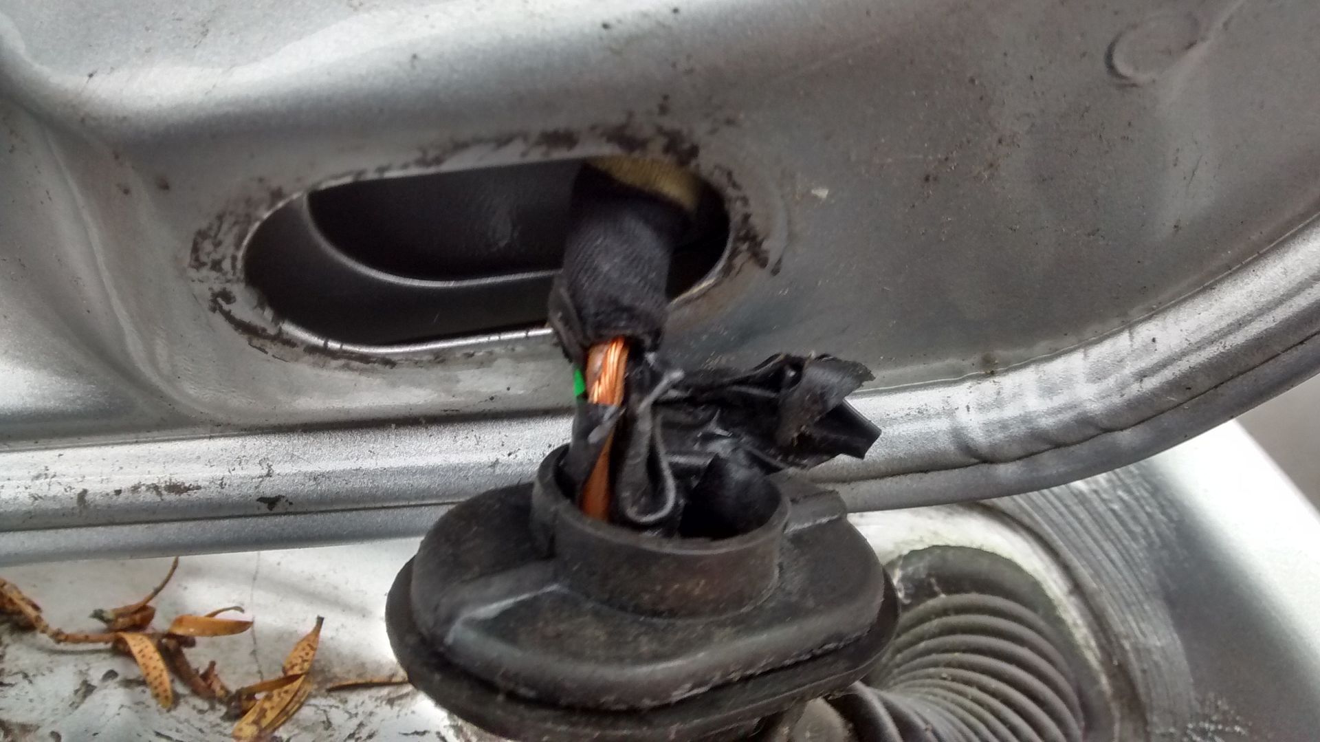

1. Tailgate wiring fraying and exposed

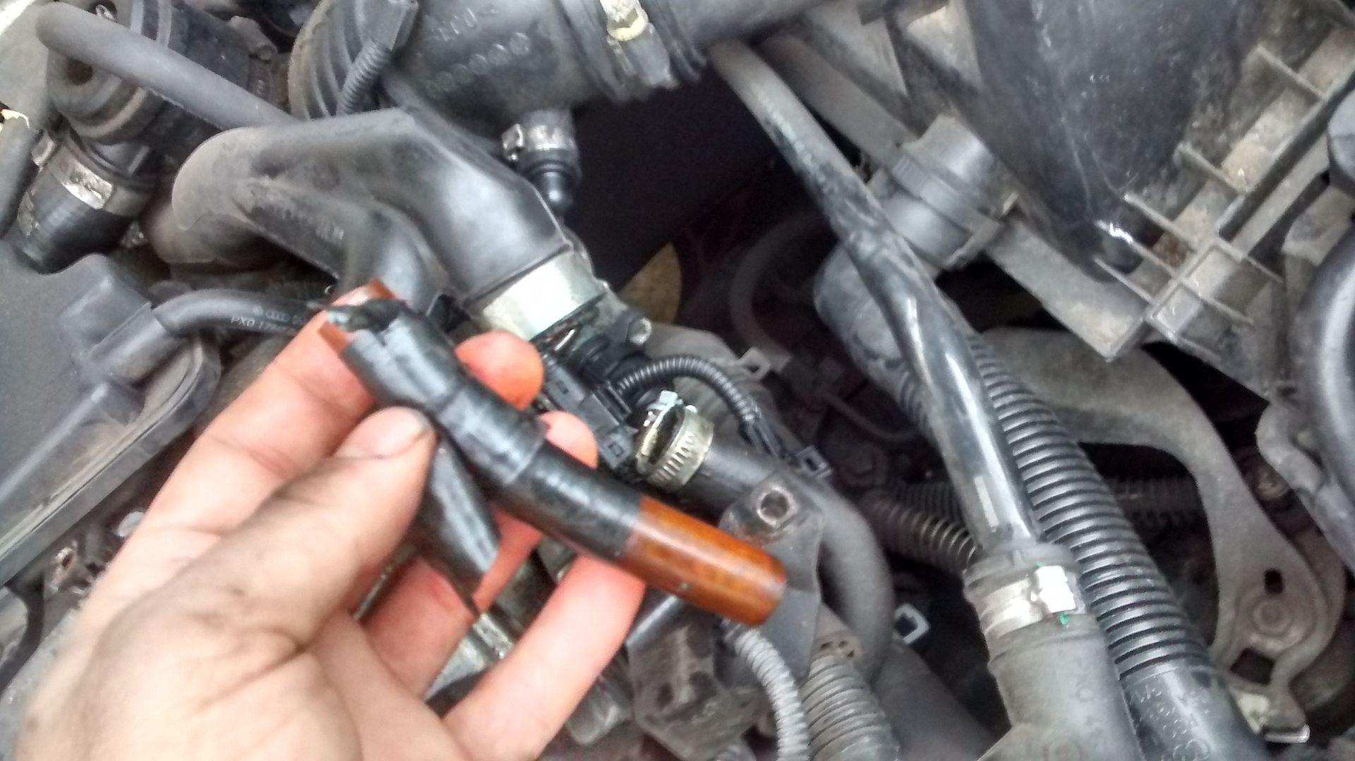

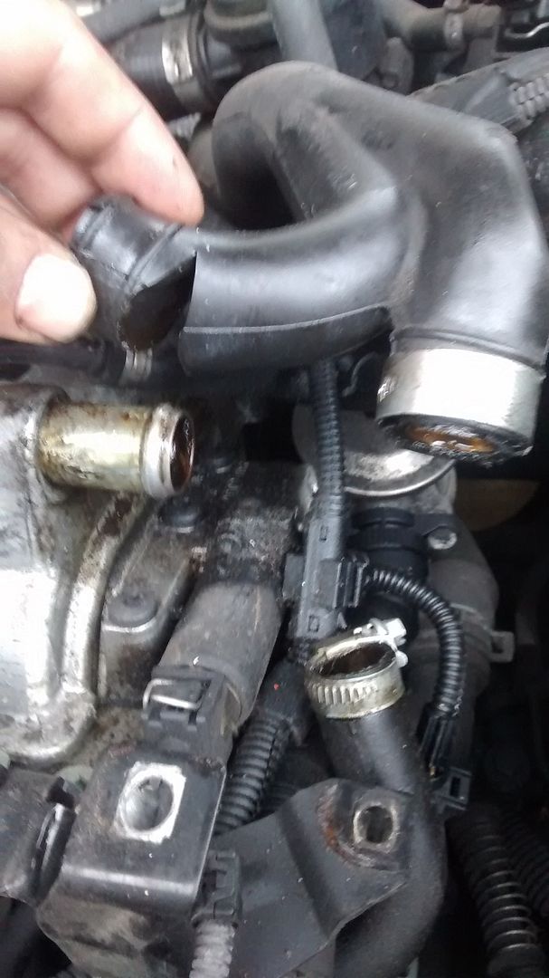

4. coolant leak above gear box  ( I found a soft squidgy hose joint as it goes into the block under the   matrix in/out....mixed with old oil deposits, only the smell was a give away to be coolant.)..it has the green type temp sender with no obvious weeping
5. PCCV hose to air intake was split and jointed with a bit of what looked like garden hose LOOL!

Good luck. The perished hoses and frayed tailgate wiring are fairly typical.
Judging by the botches, looks like a previous owner was a bit of a wrong un. Garden hose ftw!

Most of the PCV system hoses on these tend to leak now with the age of these cars, can be replaced with OEM or silicon ones from the likes of Creation Motorsport if it's a keeper.

@barrym381 do you mean the round item above/between the jubilee clips, the coolant hose thats really soft and squidgy is directly below that.. :)

no that's further back in picture but as said most of these pipes are probably needing replaced due to age  :smiley:
