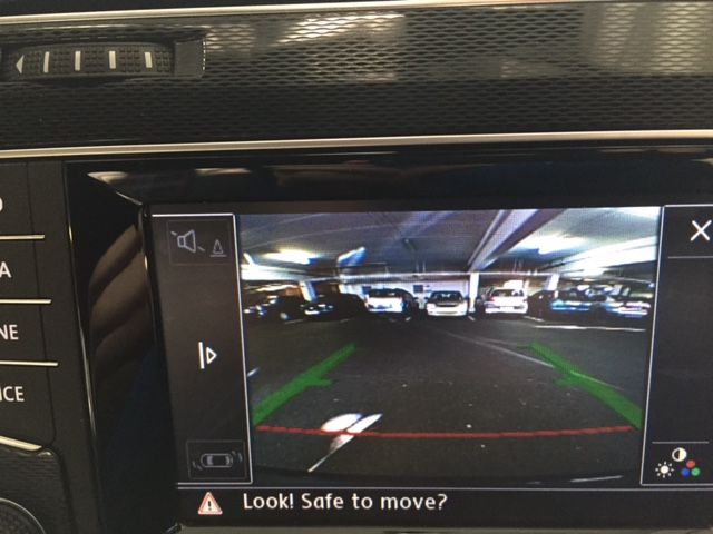

Wondering if those of you with the rear view camera fitted could take a look at this pic and tell me if it looks normal? Compare it to what you see in your cars?
I just noticed it yesterday that across the top of the image, it dips a little bit (black crescent shape across top of image) - see how it's not perfectly straight across?
I think what's happening is that "dip" is part of the boot/badge opening captured by the camera lens - the camera isn't lifting / popping out enough to clear the "obstacle". If I hop out of the car and manually lift the badge another couple of mm's, the image straightens up a bit...

Mine dips a bit.

Here's mine, not the best picture but there is no dip at all on mine, it's perfectly straight across the top..

Maybe shade on the lens?
Camera probably has auto gain and shutter, all photos with distortion on top seem to be in relatively bright daylight.

The only image I have from the camera in my GTI looks straight.

None on mine either
I don't think its safe to reverse!!

I know it's a very simple issue, whether it requires the whole camera mechanism to be replaced I don't know. Basically if I stand at the back of the car and lift the VW badge another tiny bit then the image straightens. So it seems the camera doesn't lift/pop out quite enough to give it a totally unobstructed view. I also tried wedging a piece of paper between the badge and camera and that worked too!

Have you tried lubricating the opener mechanism in case it is simply a bit stiff and flipping open fully.

Good idea. I'll give that a go. Out with the WD 40. Anything to avoid the hassle of a trip to the dealers.
