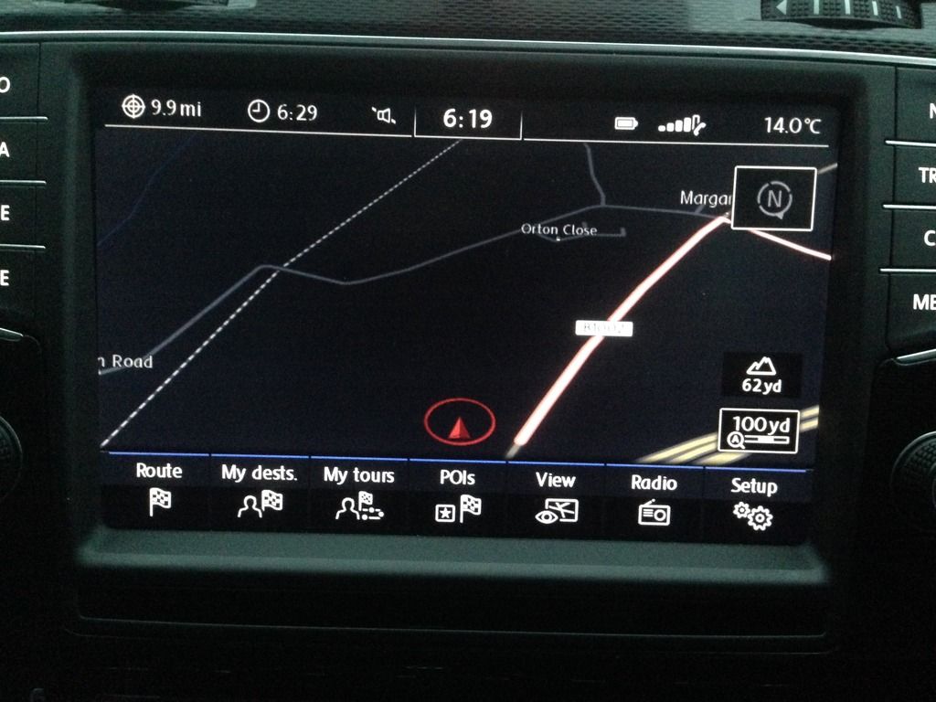

Update - Nav still crap after 24hrs of working properly I'm back to square 1 so a dealer visit is booked for next week. Recent events below show the Nav location is well off as I'm on the red line route!

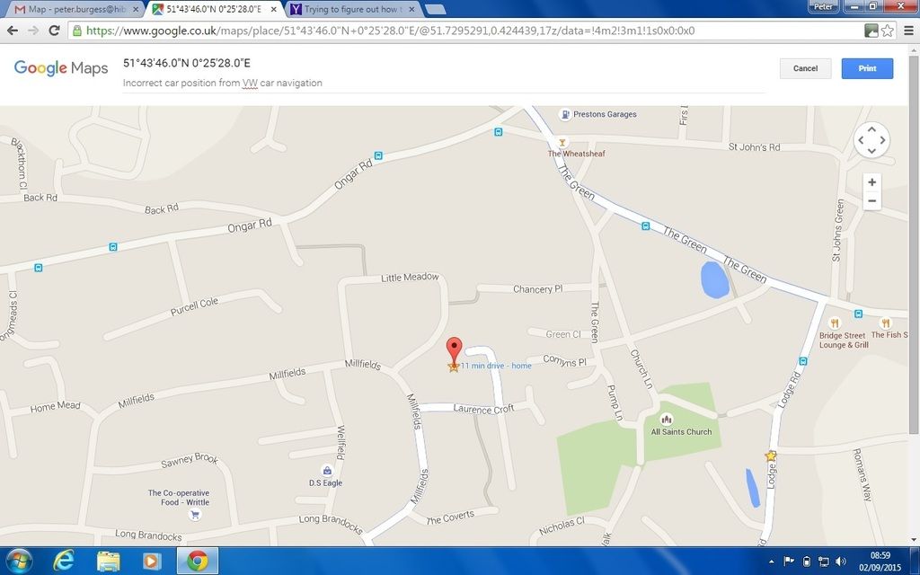

Ok with all dash cams & iphone disconnected from 12v supply I still have the issue 8-10 mins into every journey.  However this morning I was able to capture the whole issue which appears to be a possible gps issue or perhaps the pro nav unit is playing up.  The problem now happens everytime you use the nav for the first time of the day or after a 3hr stop.  It starts with a perfect location but then goes off course after 10 mins approx perhaps as the unit warms up?  After its little off course issue it completely settles down for the remainder of the trip regardless of travelling time & any short stop.  However anything over a 3hr stop when the car is off (cooling down), a restart to travel starts the whole issue again :angry:
See below
The gold star (Lodge Rd) is the correct position from my iphone nav & where I stopped, the red pin is where the VW nav says I am :whistle:
