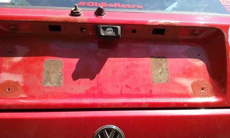

on another note I had the tailgate welded up where it had gone under the number plate lights

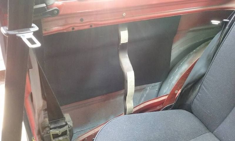

Put some sound proofing in the rear

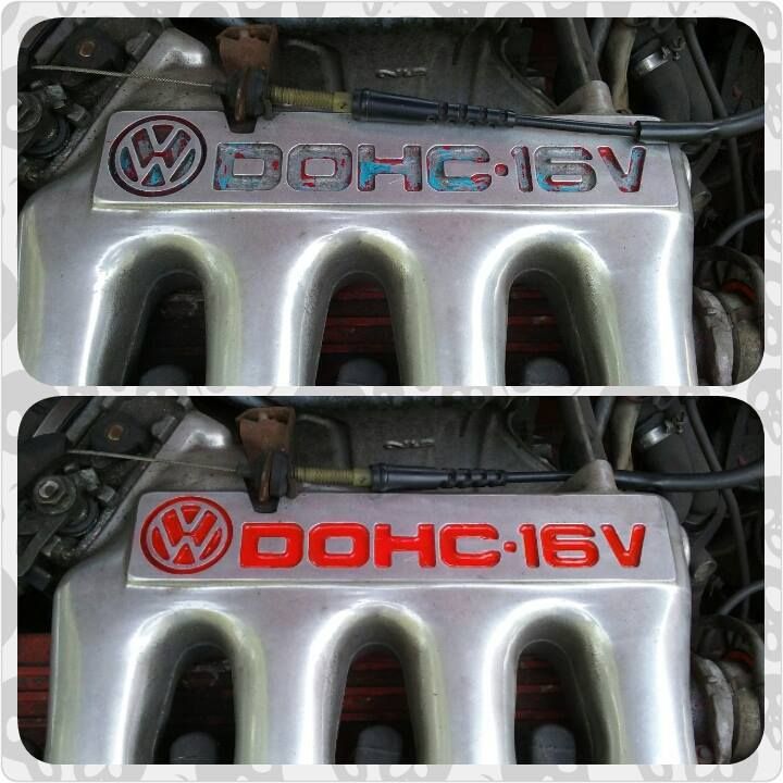

Then I painted the letters on the manifold

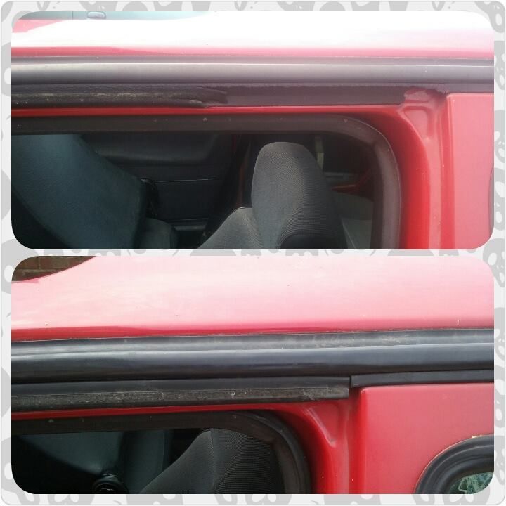

Also replaced the passenger side gutter seal and rust treated

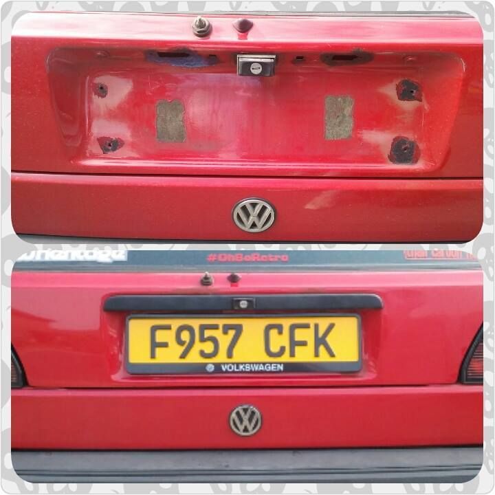

And on went my plate and fixed the boot trim on properly
