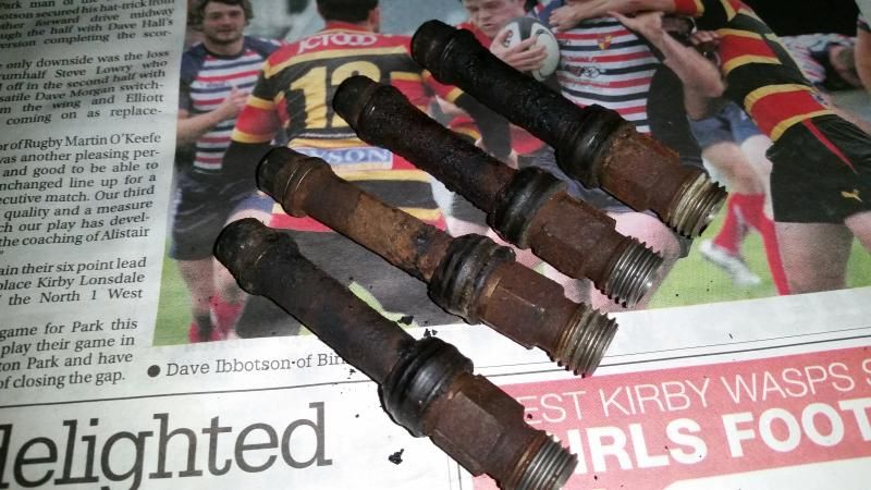

The injectors out of the 16v need cleaning. I have an ultrasonic cleaner to hand but what I need to know is what will be the best solution to use?
I currently have available to use in it:-
-Redex
-Gunk (Degreaser)
-Oxide remover (rust eater) (http://mistralie.co.uk/products/ultrasonic-cleaner-for-oxide-removal)
-or fuel
(Note I'm wont be using any of the above as a 100% solution, it'll be 1:10/2:10)

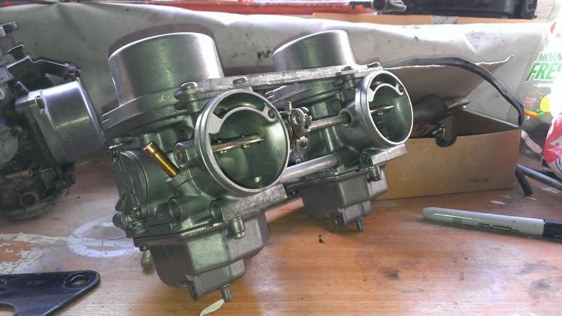

I've used gunk in the ultrasonic cleaner on my cb450 carbs before and they came out like new! I'm just a bit wary about using the wrong solution on the injectors, any advice would be very helpful.
Thanks
My cb450 carbs using gunk (You can see what they used to look like as there is another set to the left of them in the background)

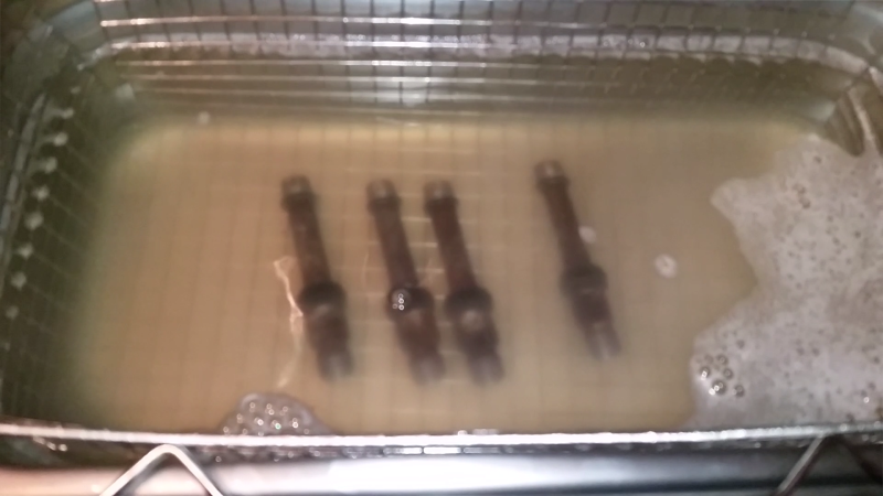

First I gave them a bath using Gunk, water and a little bit of fairy liquid to make them mix, probably not the best thing to do, but they were f**ked anyway. 15mins at 70 deg.C
Gunk and crud removed..

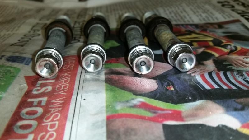

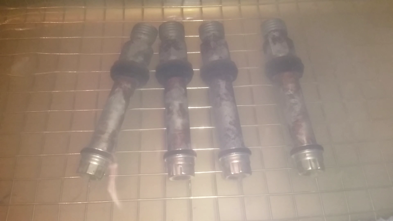

Now for the Oxide remover...
after about 5mins @ 50 deg.C
done...
I've given them a and the rubbers a good wd40ing and will fit later. Hopefully firing on all cylinders, which was the cause for me removing them in the first place. Only 3 out of the 4 were working.
