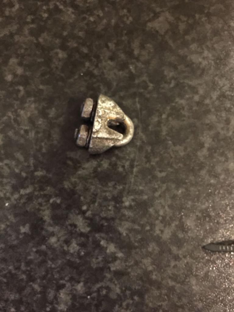

Hi there, thanks for the reply, a bit of a novice here! i managed to connect the white bit to the lock, however its how i connect all the rods to activate the vacuum pump actuator, theres a u shaped connector but cant figure out how it all fits together,
trying to post a pic but not sure how.
pic below

There's one rod that goes from the white lever to the actuator. Don't recognise the bit you've pictured, might be from something aftermarket that was installed in the past.

That's a wire clamp mate, not required on factory central locking...
Are you sure you don't have an aftermarket kit fitted?
