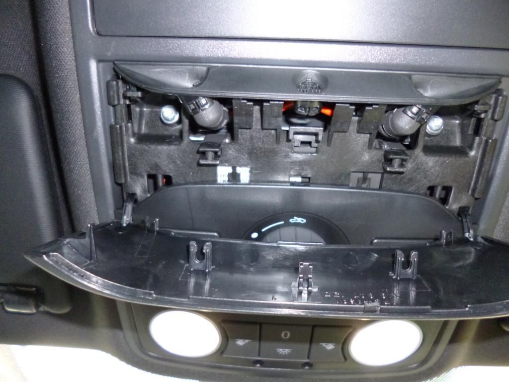

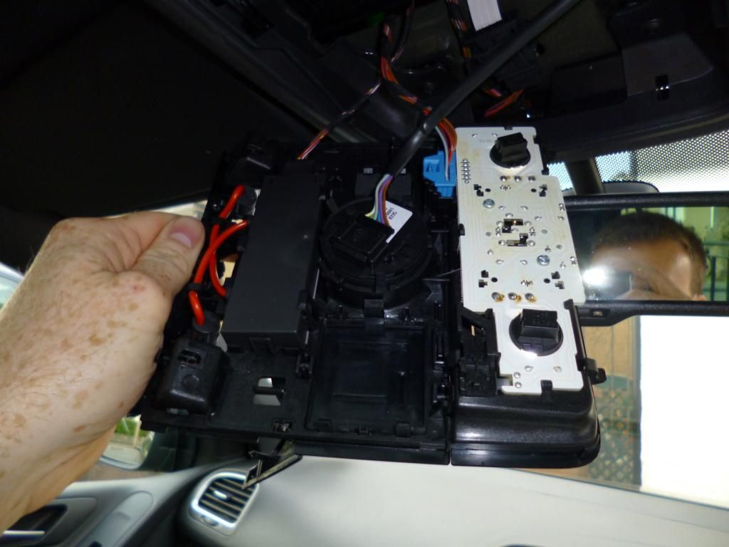

I'll take some pics for you now
Offline Mattyj
  • Posts: 825
Re: Interior lights
« Reply #2 on: 28 September 2014, 17:34 »
Pull this down clips down
Two t20 torx screws
It then clip off
Twist the black circulers plastic bulb holders out job done

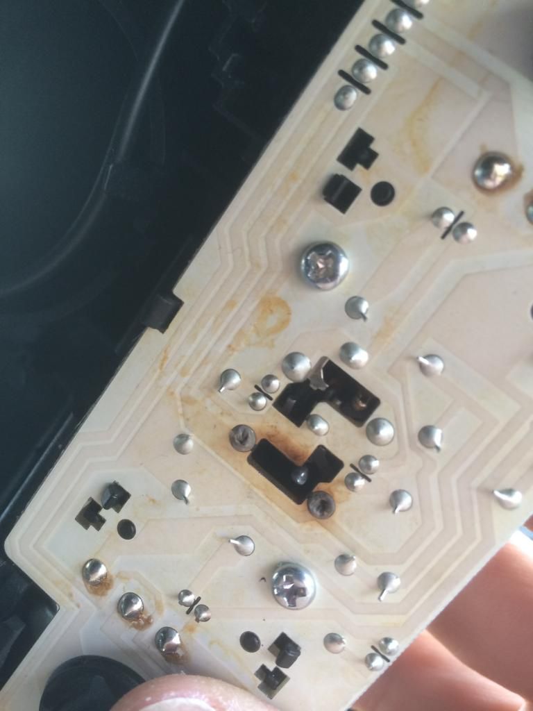

Thank you. My circuit board looks burnt out. Anyone seen one for sale ?

Looks like a burnt out component look where the solder is very dark
