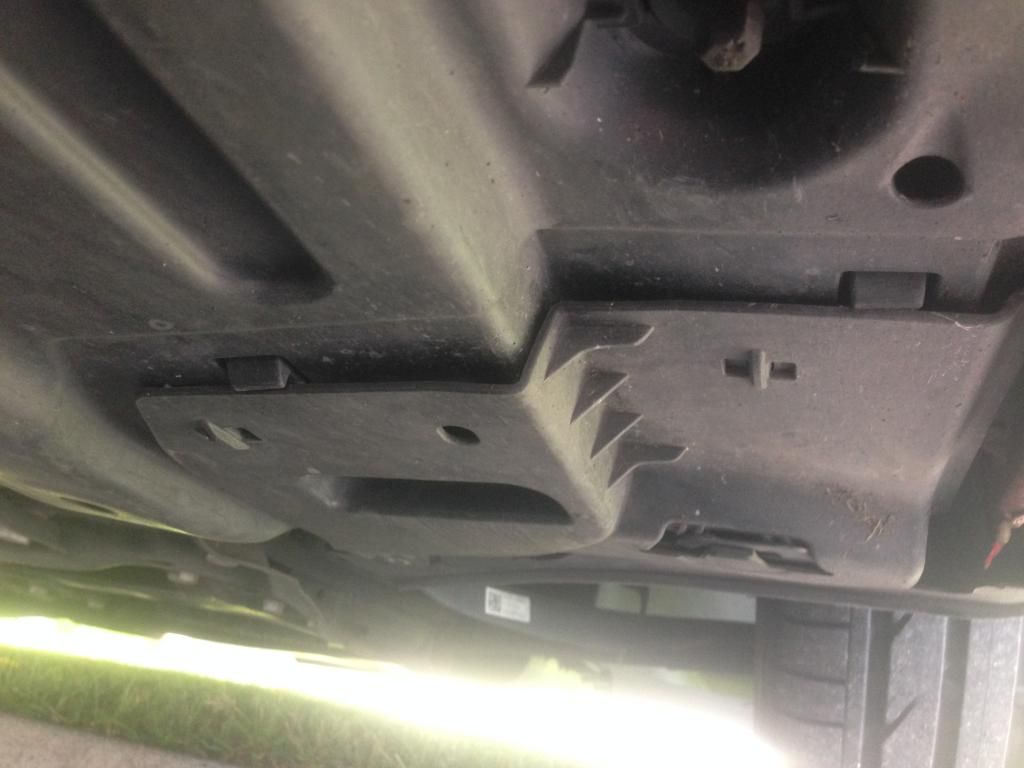

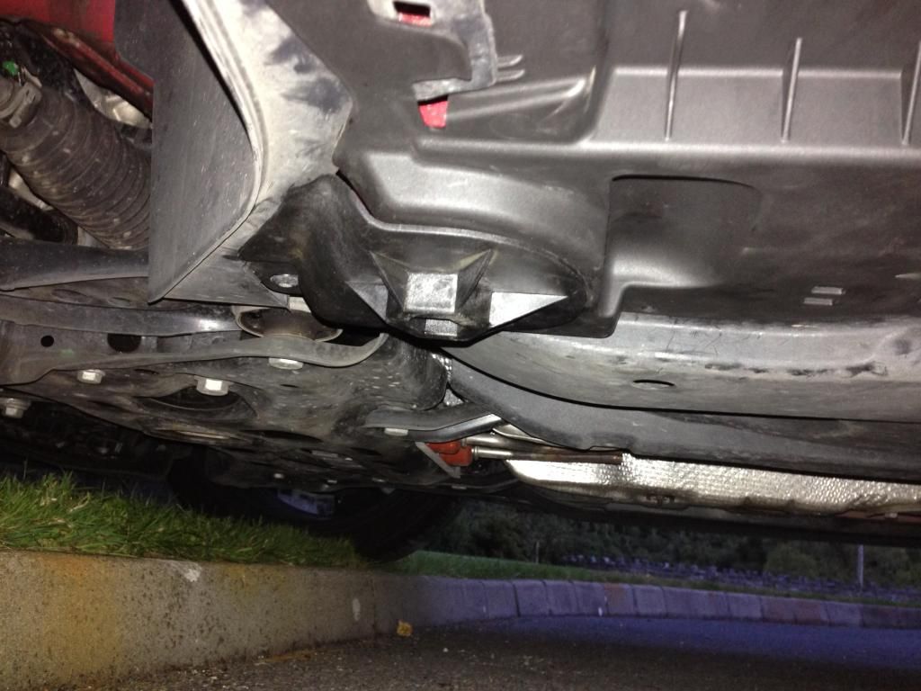

In the middle picture, do you actually jack on to that flat plastic part? It looks really smooth and easy for the jack to slip! Whereas the jacking point in your last picture looks ideal as that would nestle into most jacks!

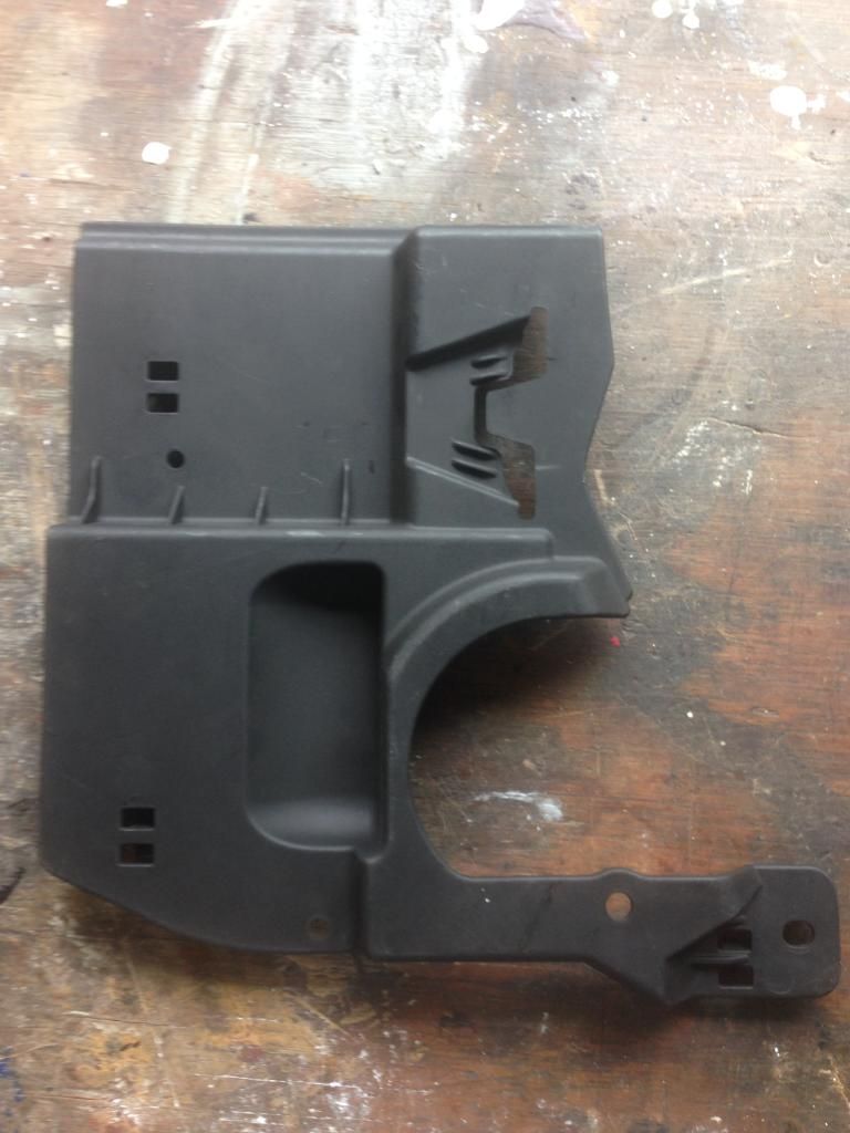

The first 2 parts I list are not in the picture. They are underbody trims. You have to remove a trim each side to reveal where the jacking points go. The first 2 parts are new trims to go with the jacking points. You can see it in the last picture. It is the clean darker plastic to the right and above the jacking point. I have more pics of the jacking points on my friend's phone. I'll upload over the next few days.
The jacking points are hard plastic. They would not work well with those cheap trolley jacks that have the metal head on them. My jack has a rubber pad moulded into it so it works perfectly.

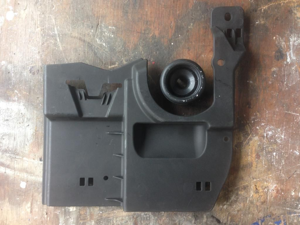

Here are a few more pics of the front jacking point:
This is the driver's side looking forward. Remove the T20 screw securing the existing trim. Release the tabs and slide the trim rear-wards. This will take a lot of force.
Here is the factory fitted trim beside the new one:
Lube the rubber bung with washing up liquid or your lubricant of choice  :wink:
Press the rubber bung into the mount:
You will need a jack to press it all the way in. Even this wont get it in fully. When you release the jack, rotate the bung until you hear it click. Make sure it is fully in before you move on.
Fit the new trim and put back in the T20 screw:
The press in the plastic jacking point with the jack:
Job Done!  :cool:
