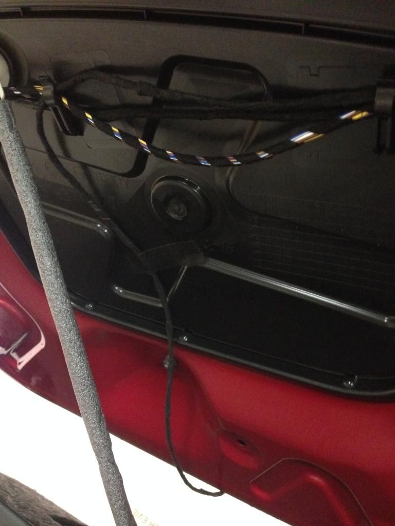

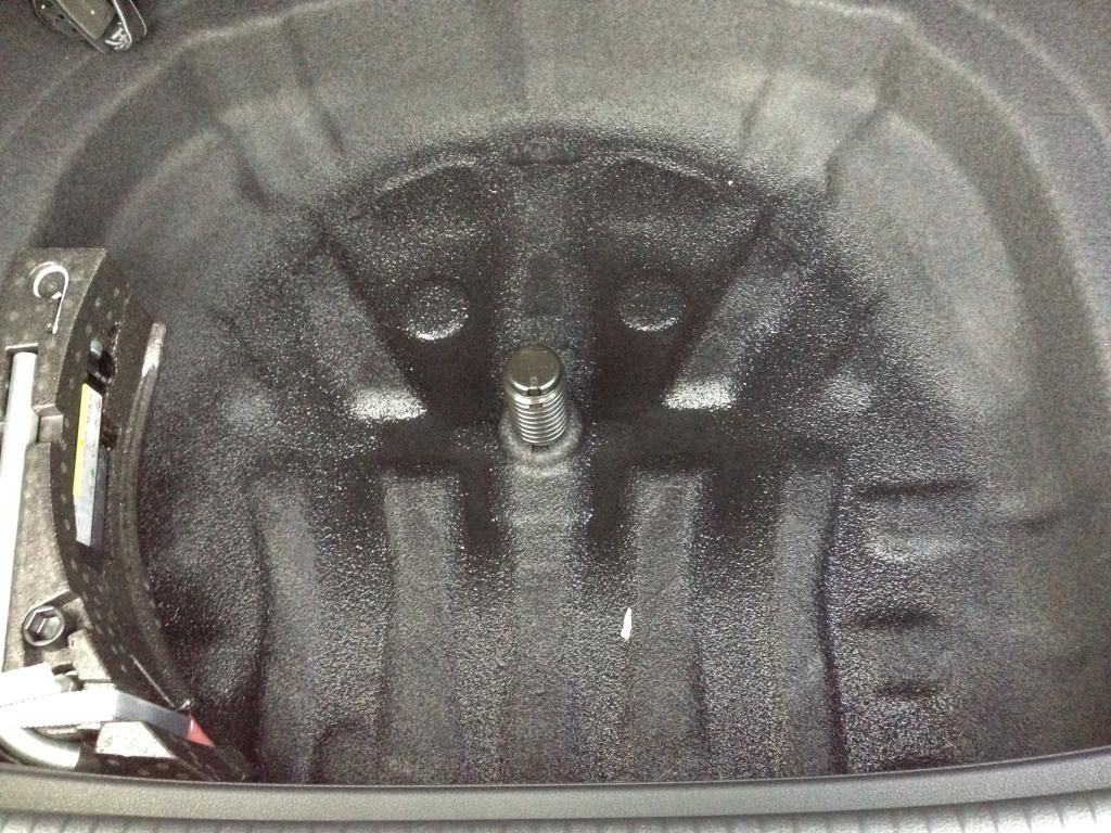

A few weeks ago I lifted the boot floor to find this:
The usual suspects (lights/seals) were checked and came back fine. It was eventually chased to the boot hinge. VW don't put a sealant there in the factory, they just rely on the paint to seal it which is a bit crazy. The dealer did a top job finding it and fixing it. Here is the hinge with the sealant applied:

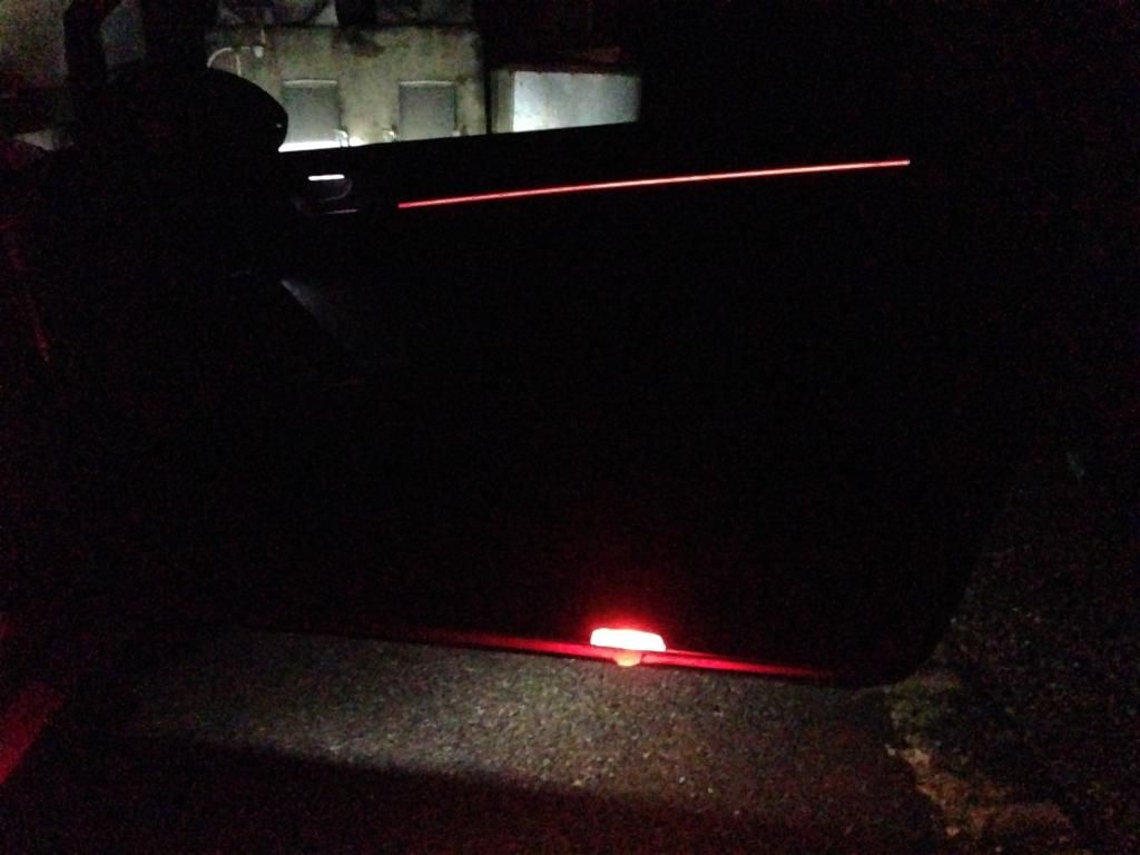

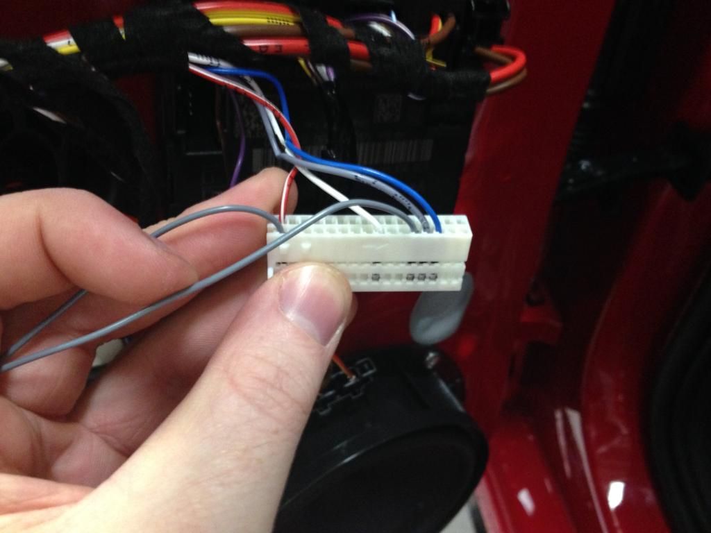

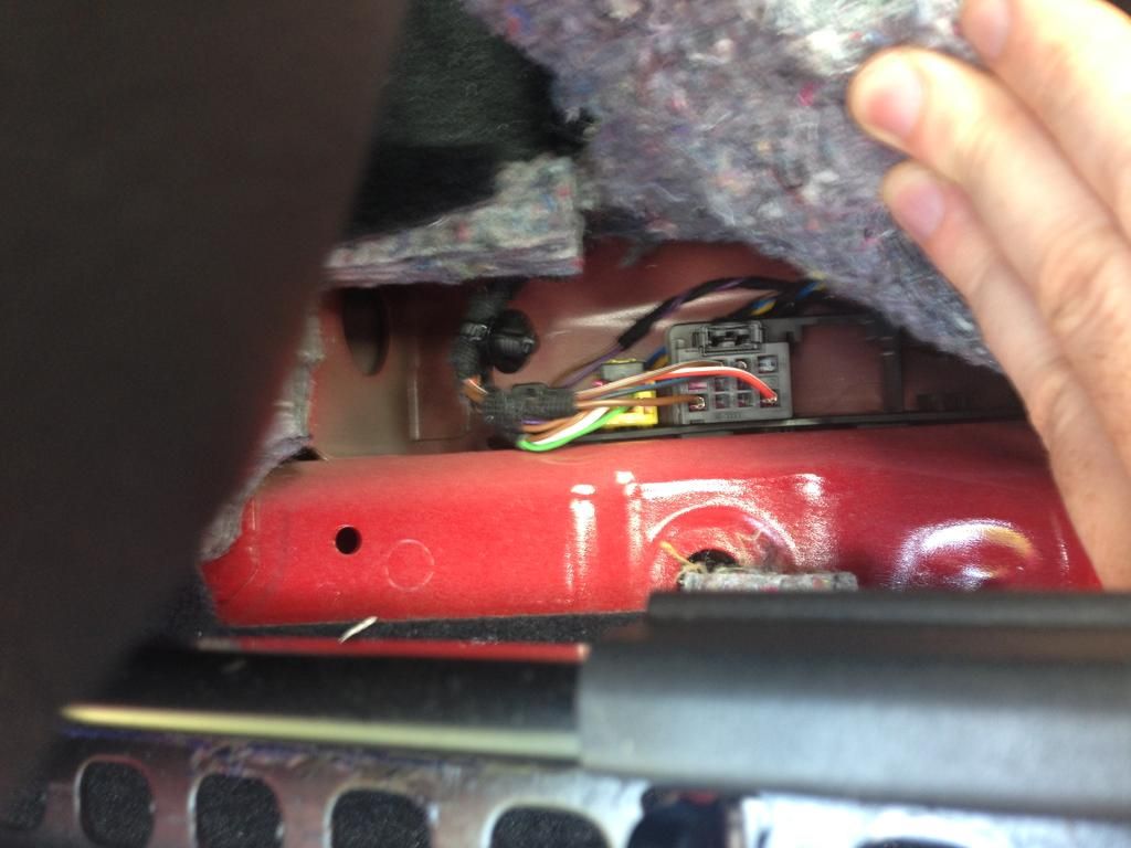

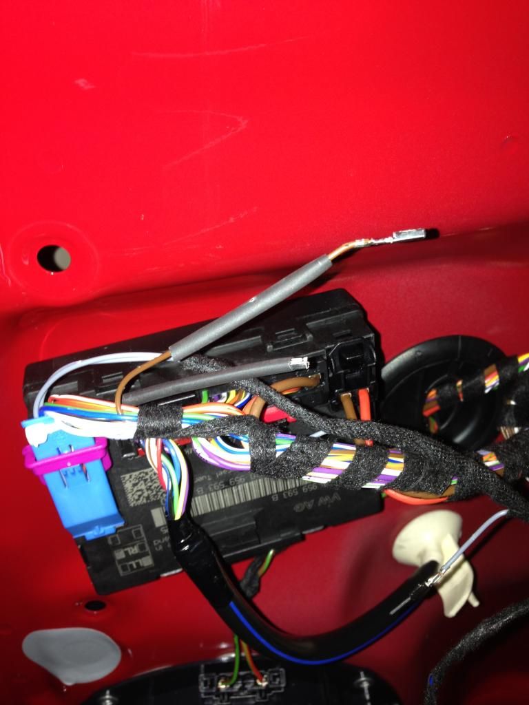

Next I put in door warning lights. This is more tricky to do than on mk5/6 as there are no vacant pins to just plug into. The door warning light pin in the door controller feeds the illuminated door sill. There was no vacant ground pin either. I avoid damaging factory wiring if possible to I built a loom that plugs in between the door module and the factory wiring loom. I split the power and ground in my loom. This way I can remove it again and leave no damage to the factory wiring. Some pics:

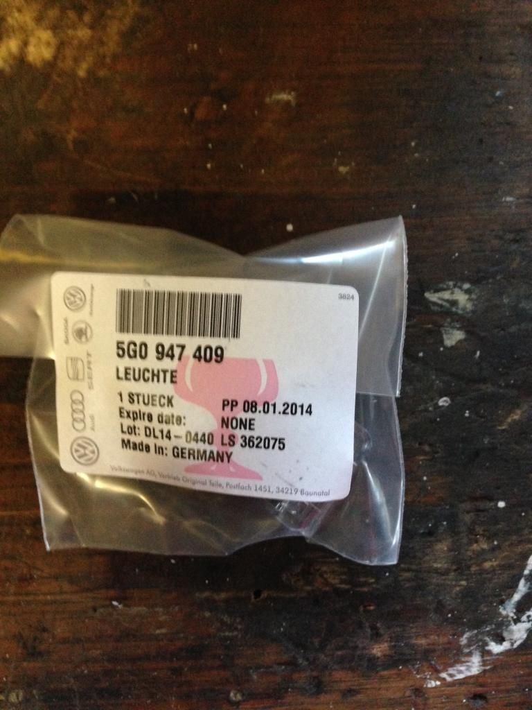

Next I replaced the glove box light with the led light that is used as footwell lights in the mk7. It was a nice easy straight swap. Part number of the light is: 5G0 947 409. It was about €8 IIRC. Standard light on left, led on right:

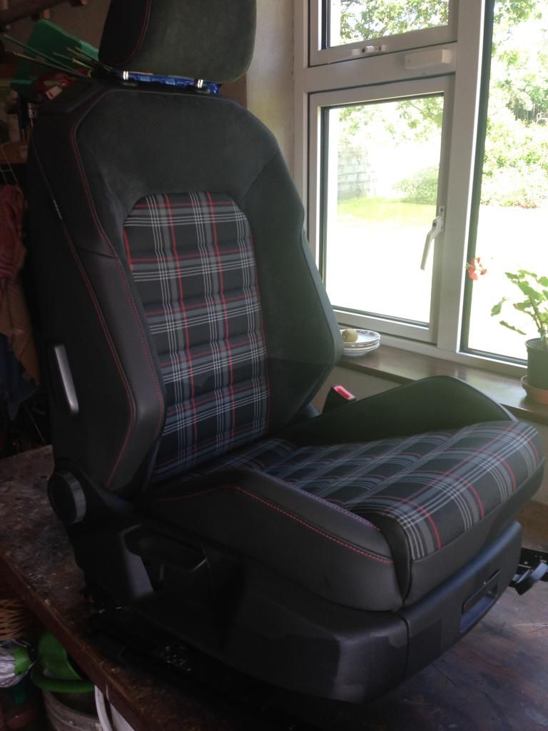

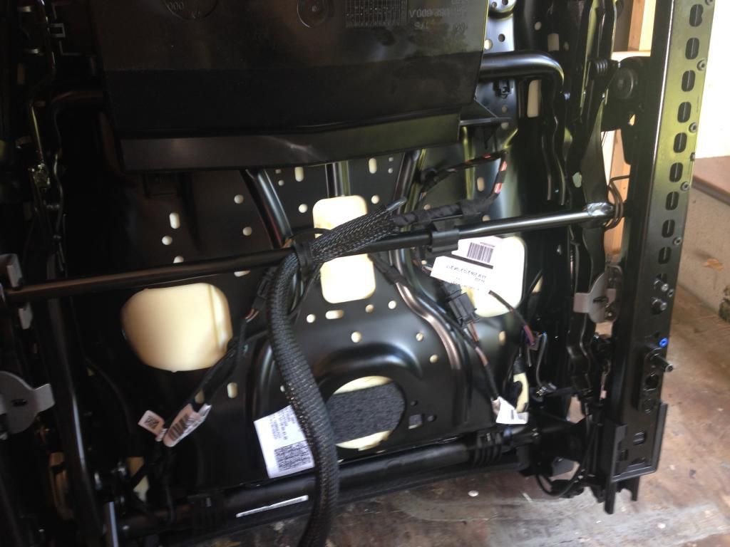

I then fitted led footwell lights to the rear. The holes are in the seat frames. I built my own loom as the pre-made loom by-passes the plugs where the seat loom plugs into the main car loom. This means you cannot remove the seat without cutting the wires for the foot well light. There were empty positions in the plug for seat heating in my car so I used them. Again, my loom plugs in between the front footwell led and factory loom for power so no damage to factory loom.

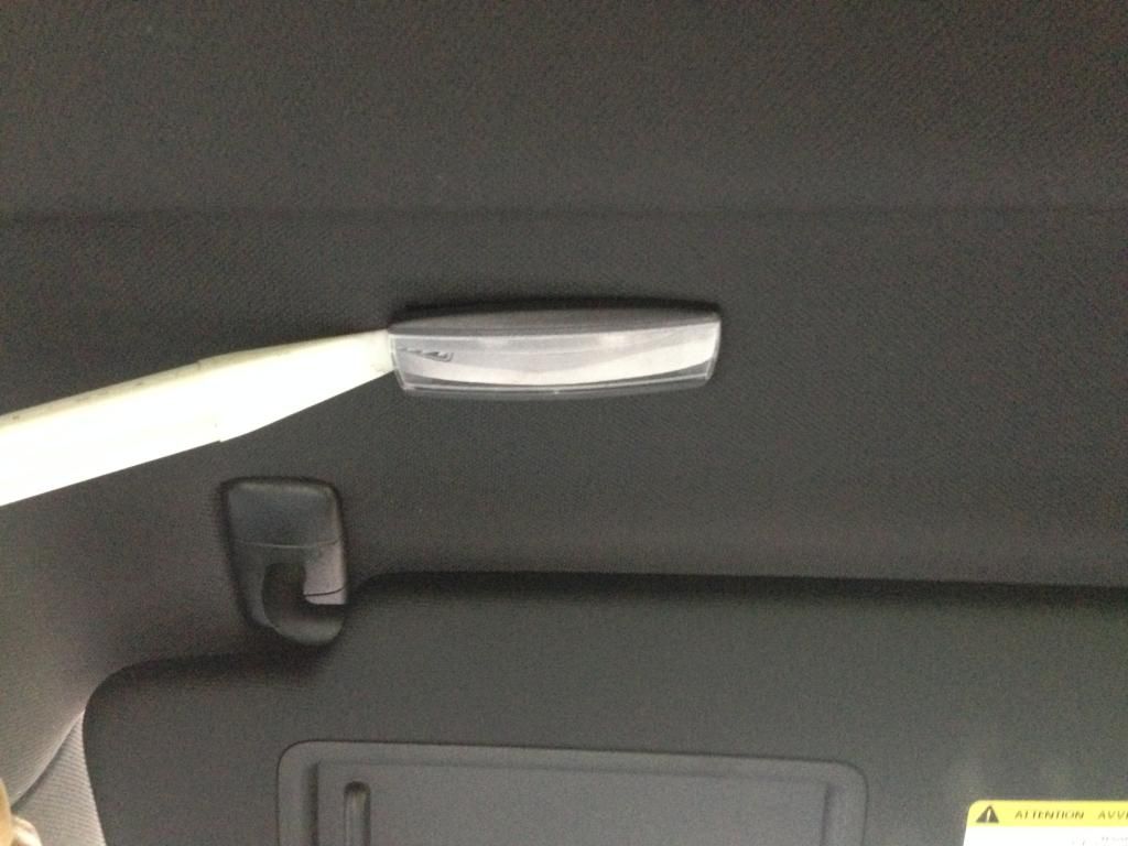

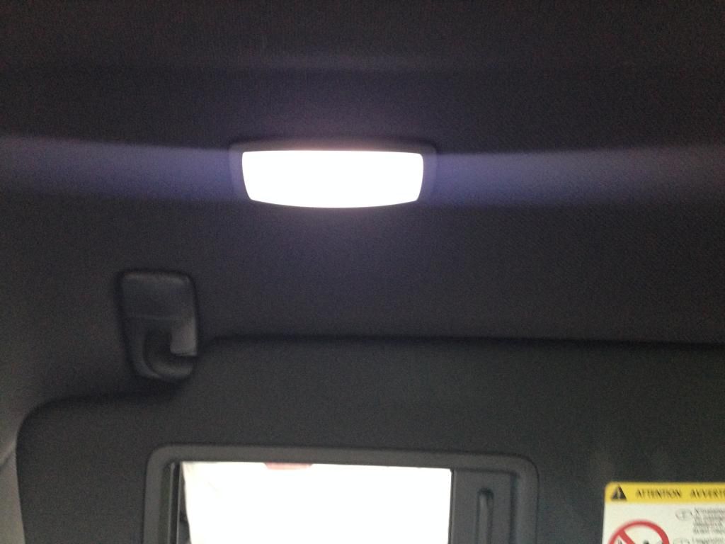

I then fitted genuine led vanity mirror lights. They are not factory fitted to any VW's to the best of my knowledge. They come as part of a pack on the Seat Leon. They are a straight swap. Part number is: 5F0 947 109 B. Price is €13 each.To remove the existing light, stick a flat tool in from the door side of the light. (Note this light comes in different colours to suit the interior colour)

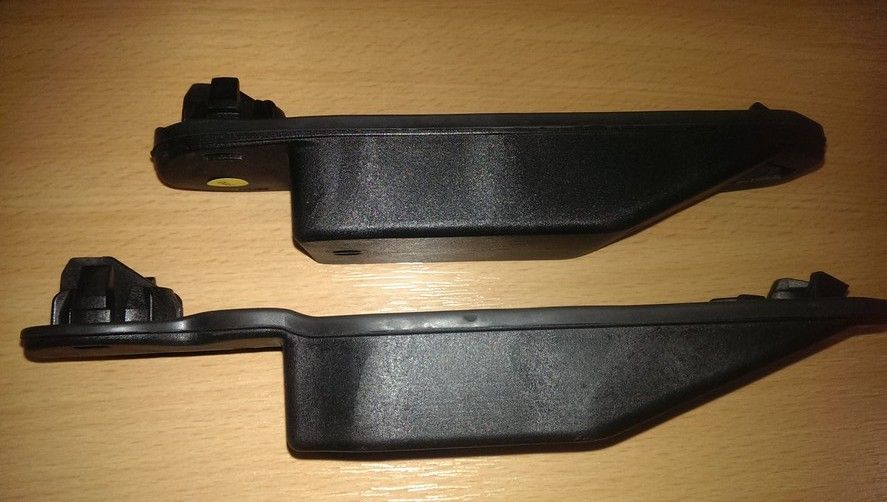

The most recent mod I have done is the Audi jacking point mod. This mod has been around since the mk4. Parts required are (Note: These are Audi parts so probably have to come from an Audi dealer. I got them from a dealer that's both Audi and VW):
8V0 825 271                       Qty:1
8V0 825 272                       Qty:1
8V0 802 845                       Qty:1
8V0 802 846                       Qty:1
8V0 802 847 A                    Qty:2
8V0 804 631 B                     Qty:2
EDIT: A note on the rear jacking pads: There is a mix up on the part numbers. There is a non-A and Rev-A version of the rear pad. They are different lengths so the non-A will not fit Golfs. I ordered 8V0 802 847 without the A at the end. My order must have been mis-picked and I got the Rev A's. The packaging said non-A but I never checked the part number on the pad itself. I did not realise this until Simon (C2K) contacted me after getting the wrong parts. The shorter part in the pics below is the correct one (Rev A). Credit to Simon for the first 3 pics below and figuring it out. I can confirm that the Rev A fits both 3 and 5 door Golfs. I have amended the list above. Apologies for the mis-information.

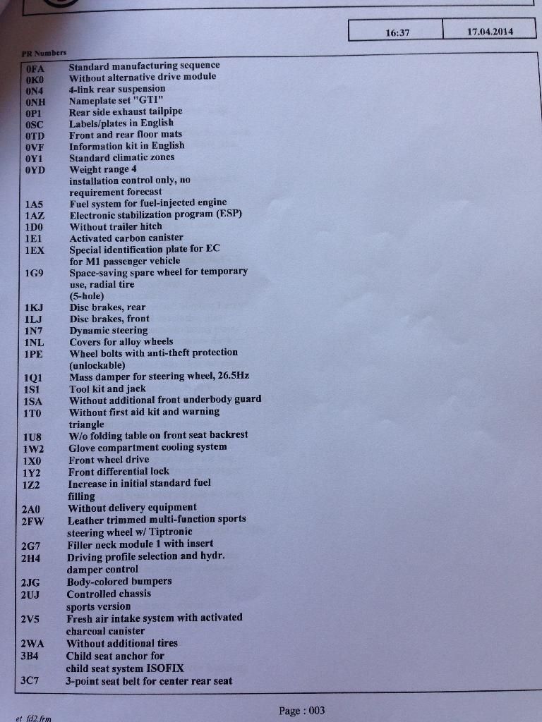

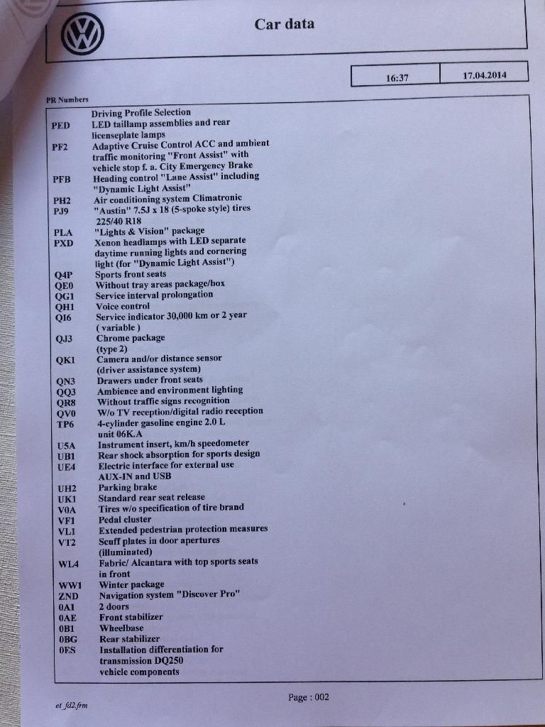

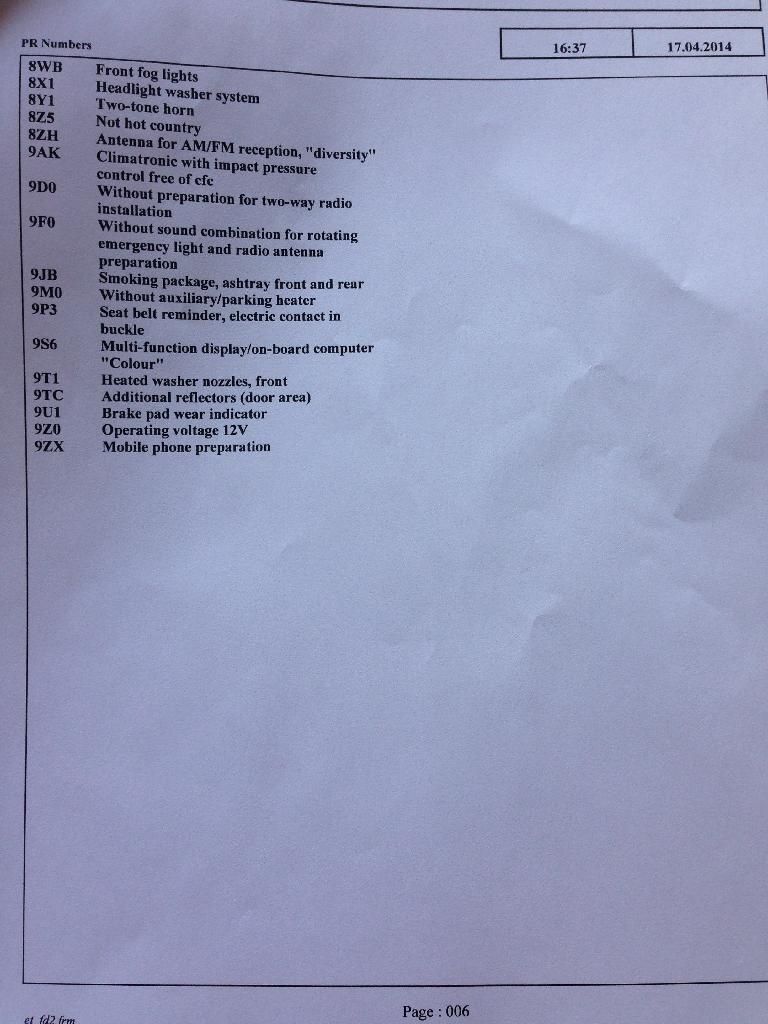

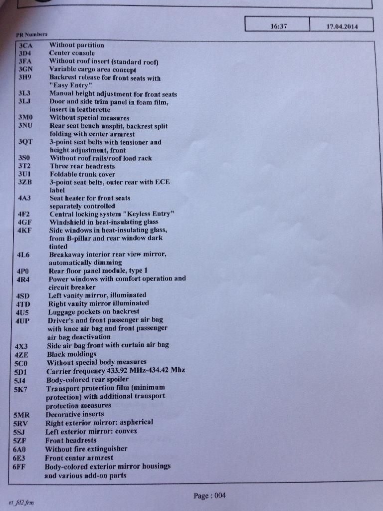

I also got the full PR-code list for the car. This is basically the car's DNA and lists out every feature (whether standard or optional) it has.
