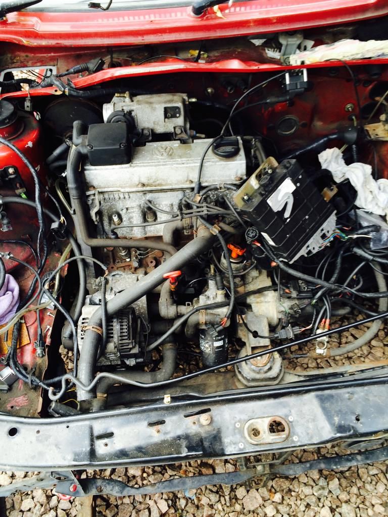

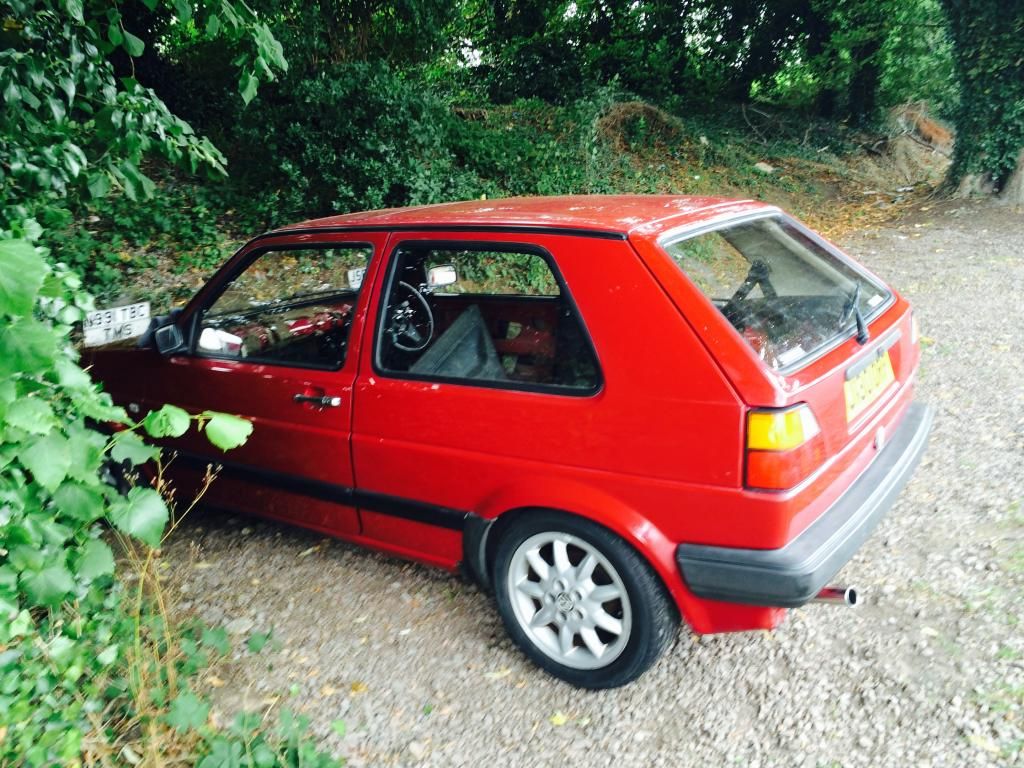

hopefully this help as its the only pics I've got  :smiley: from this
in to this
this is how i got the mk2   :embarrassed:

Mk2 Ryder with a 2L 8v installed already. You checked nothing else has been upgraded at the same time?
