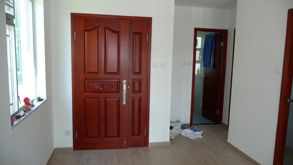

Cool Clancy here is a picture of the build not that long but this was domestic a living room space the kitchen and bathroom are located on either side. As this will be basically a floor with just bedrooms I can leave kitchen off and use it for bedroom space. In one of the pictures the bathroom is at the front on the entrance and the bedroom is near the back where the window gives good light TBF the bathroom can be in the dark as its not uncommon for just a light to be turned on?  I'll do my best with the drawing but it will look rough mate! :grin:
This is where the living room would be but I want more bedroom space and just a narrow corridor roughly about half of where the patio metal doors are is where the bedroom would come out to!
Best I can do logistically The bathroom needs to be near a side wall of the house for waste management reasons other wise I'll have large waste pipes going through all floors where if they are routed outside of the building which is the way its done over there!

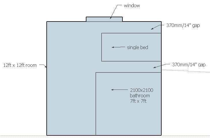

just done a very rough drawing i kinda had an educated guess at the size of the bathroom (think it needs to be smaller  :whistle:)
