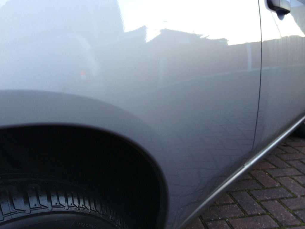

I had 2 bad scratches on the back of the car where my golf bag scraped the car, wasn't particularly happy with it obviously so spoke with a mate who is a keen detailer. Rather than a deep cut it just looked like a white streak. He took some G3 to it and it came out a treat. However, on the back panel on the drivers side he noticed another mark and attempted to fix it... its now a bl00dy mess.
He promised me he could bring his polishing machine and maybe see if it will buff out if he takes a mil of the paint or something. Ive spoken with Chips away, but they said it'll cost a couple of hundred. Suggestions appreciated.
Photos attached. Looks worse in person  :cry:

Run your fingernail over it gently. Can you feel the scratch?
No cant feel a thing. So i presume il be able to have this machine polished out? Have you done this yourself or is it dangerous territory?

As long as you can't feel it with your finger nail then it won't need a panel painted! You may need a few passes with different compounds and pads on a rotary/DA. But it can be done.

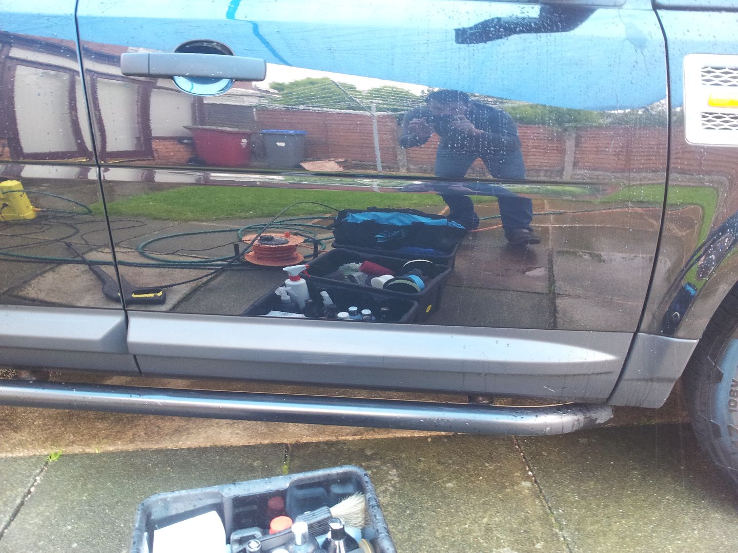

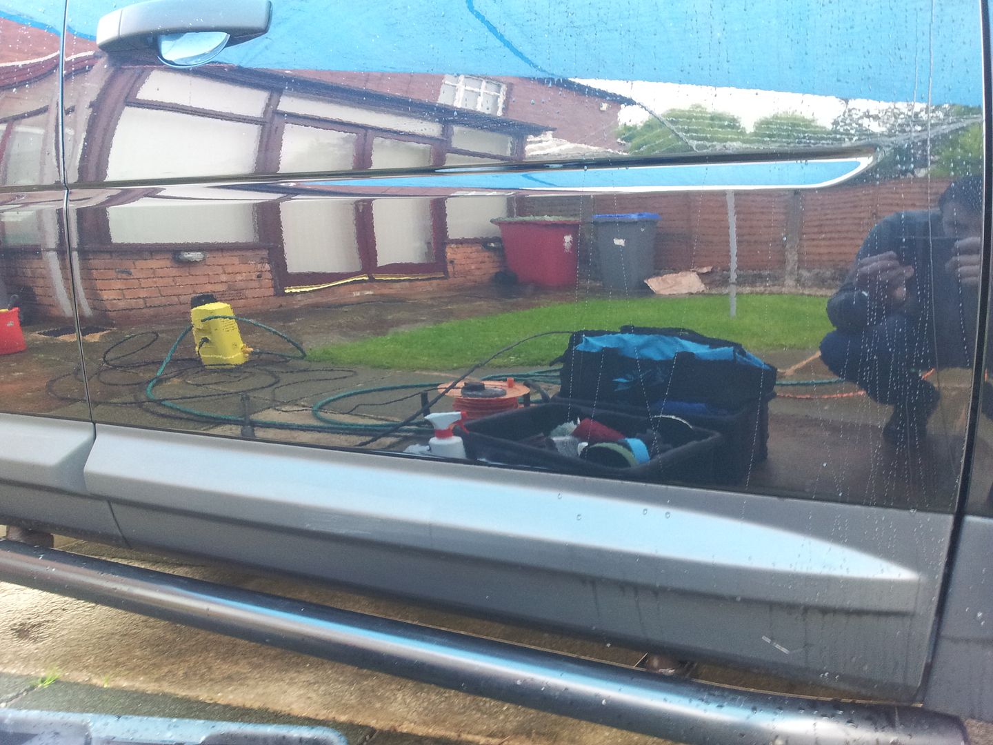

Yes that will polish out no problem. You need to introduce some heat into the paint to remove a couple of microns of clear, that is all.
I repaired a scratch on a black Freelander a year or so ago, came out like new...
Before:
During:
After:
Here is a link to the full thread if you're interested to see the full process:
http://www.detailingworld.co.uk/forum/showthread.php?t=280577
There are plenty of great detailers in your area who will sort that no problem!
