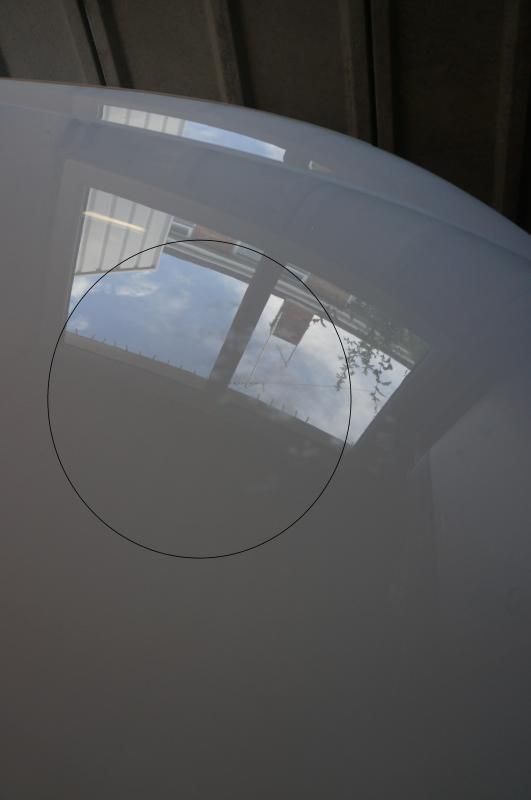

On giving my car a good clean this weekend, I discovered that there was an imperfection on the bonnet in 2 places, it is not obvious but I know its there.
It looks like where a sticker has been, but its near enough in the middle of the bonnet.
I will try and post a picture tomorrow as i want to try and get it off as it is the only thing that lets it down when it is clean.
 Anyone got any ideas on how to remove this I would be very grateful.

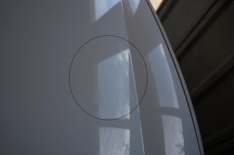

I have managed to get a few pictures of it, I will try and get some better ones when the car has been washed and the weather allows me to.
Defects have been circled.
Cheers guys.

I'm not just being fussy am I?

If I'm looking at the right thing (bit tricky to see) the irregular shaped patches look like etching from bird lime to me.  Will need polishing out if it is.

And try and get some more photos in better lighting if that doesn't work. the reason why I thought it was a sticker is because it seems to be in one patch (which could be bird lime) and then in the top photo it seems to be in a straight line up the bonnet.

Lol, yeah I see it now.  Could be from a sticker.  Why not clay bar it first, followed by a glue/tar remover or good APC if it persists. If all that fails then polish.
