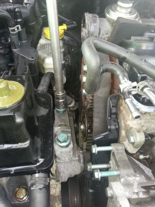

Then whip off the coolant reservoir, PAS reservoir  18mm engine mount bolts mount to mount, 16mm bolts mount to chassis and the 13mm bolts on the stabilizer. The 18mm bolts MUST BE REPLACED. They are one use stretch bolts.
THERE WILL BE A BOOST PANCAKE PIPE IN THE WAY HERE, two clips on each hose either end and a 10mm spanner will have it right off.
Lower the engine to gain access to the three horizontal mount to engine bolts. All 16mm and all MUST be replaced as per the 18mm ones.
