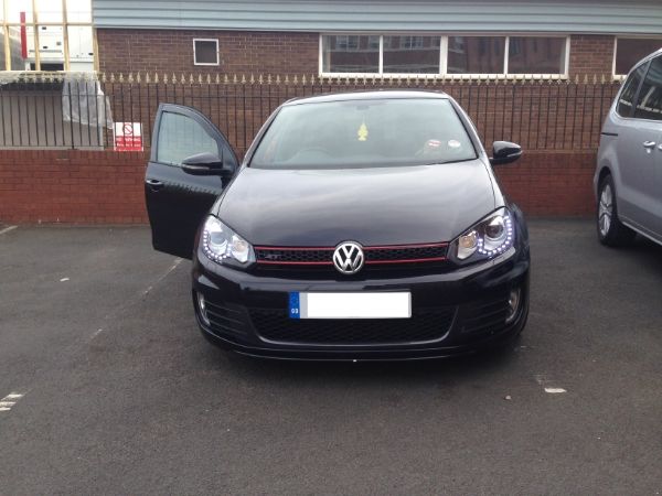

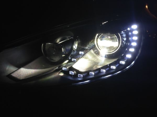

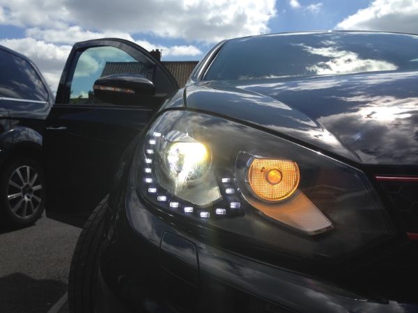

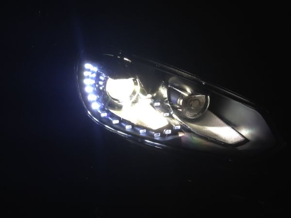

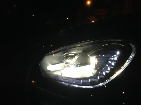

So I went ahead and ordered a set of these last week, as soon as i got them through the post i fitted them within the hour, taking about 1.5 hours. Totally love them! Comes with 4300k HID's. The LED's are now wired up (jumped pins 4 and 10) to act as both DRL's and parking lights and act as OEM behaviour. Completely finished off the front end. I am aware that the LED's and the 4300K HID's are slightly different in colour, but it doesn't really bother me
Here are some pictures:

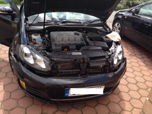

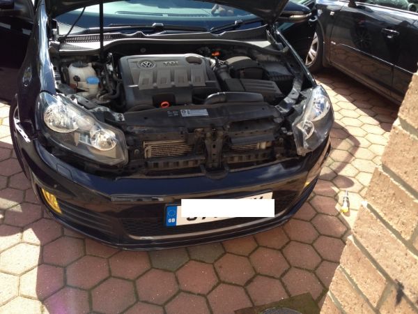

Got them from Xenonz.co.uk, he gave me a discount price. But you can get them from china for cheaper from vacar.com.cn
Installtion was relatively easy, here are some links i used for reference
https://www.youtube.com/watch?v=EwD4UNzZAfg
http://www.golfmk6.com/forums/showthread.php?t=76148
http://www.golfmk6.com/forums/showthread.php?t=49673
I expected it to be more difficult, but in reality it was quite straight forward. Hardest part was disconnecting the connectors from the origional headlights
