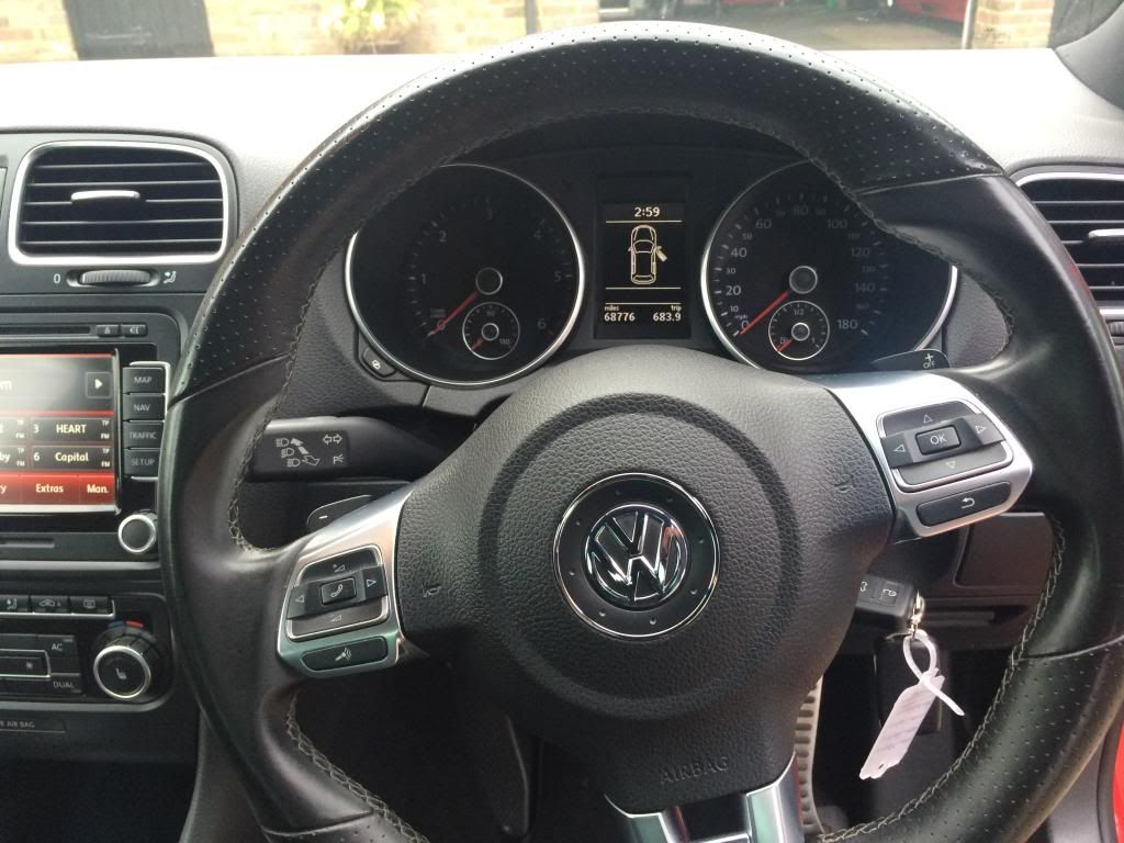

Hi guys,
I'm sure many of you hate a shiny steering wheel, gives the look of age and mileage on the car.
Been looking for an inexpensive way to clean steering's for a while, came across this magic eraser, these are for bathrooms etc, I couldn't wait so I got a flash magic eraser from tesco, I had to wash the detergents out first as they do contain bleach so after 10-15 mins washing I got to work, this car has 69k on the clock and was pretty dirty I think not the worst I've seen though.
These are some before and after pics! enjoy
as you can see not pleasant.

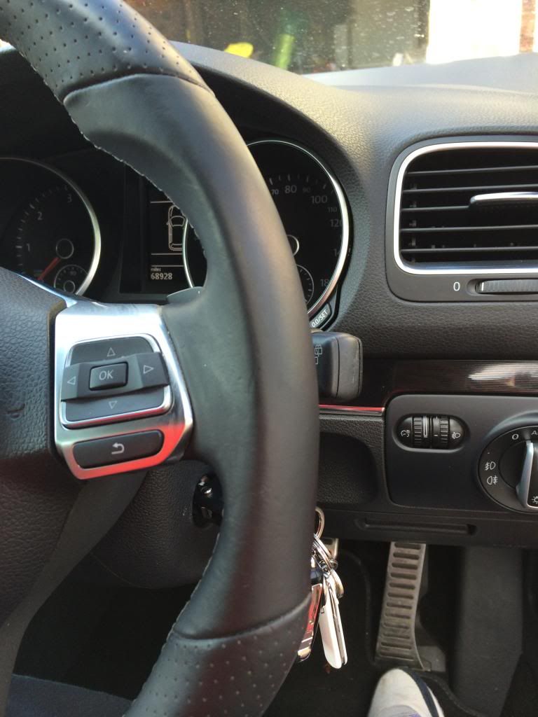

A few light passes while wet (they work only with water) it came out looking like this

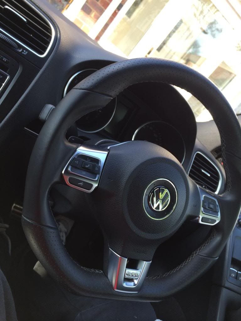

Then after a few times going over I got to this!
Much better!
Be careful with these guys, I've read that they can remove the dye on leather if used harshly, they are not designed for leather, do so at your own risk as retrims are expensive!
