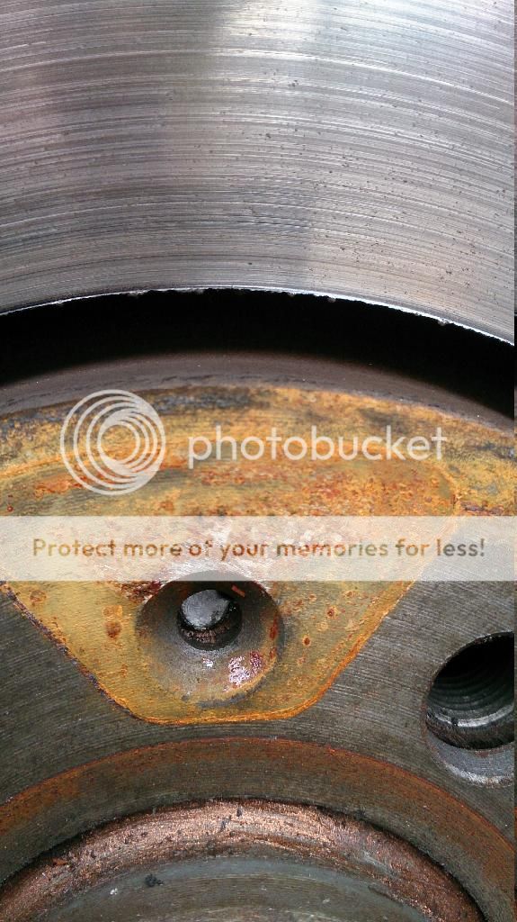

Also worth mentioning that the retaining screw for the brake disc has sheared off:
This shouldn't make a difference though should it? As it's only used to locate the disc for fitting wheels.
Offline mcgee9t2
  • Posts: 3,289
Re: Vibration and knock
« Reply #5 on: 28 April 2014, 13:11 »
yeah that shouldnt make a difference, wheel nuts will hold it on, i sheard mine off on the old car,
