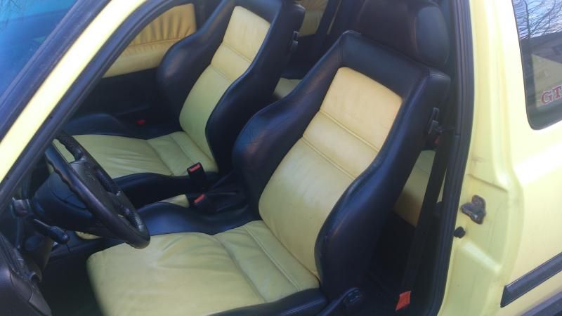

Offline snozan
  • Posts: 171
Re: 5 door seats to 3 door ?.
« Reply #7 on: 21 April 2014, 11:24 »
As above, if the colour concept seats are expensive you might want to look at just getting your current ones re trimmed in brand new leather. It's cheaper than you'd expect :) and they look brand spankers
Or, get a "passenger" seat from Germany. Which would be your driver seat. As for my Passenger seat (Colour concept) it looks brand new.
Hope i made some sense :P (you have left hand traffic, rest of europe have right hand traffic)
(my "passenger" seat would be your driver seat):
