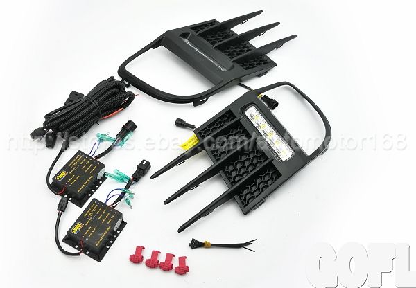

I didn't try the coding, couldn't be bothered as I already had these DRLs fitted:
Here is the thread where the guy linked the pins:
http://golfmk6.com/forums/showthread.php?t=33377&page=9
I did not have any errors with the LEDs as sidelights, I had already switched off the original DRLs.
