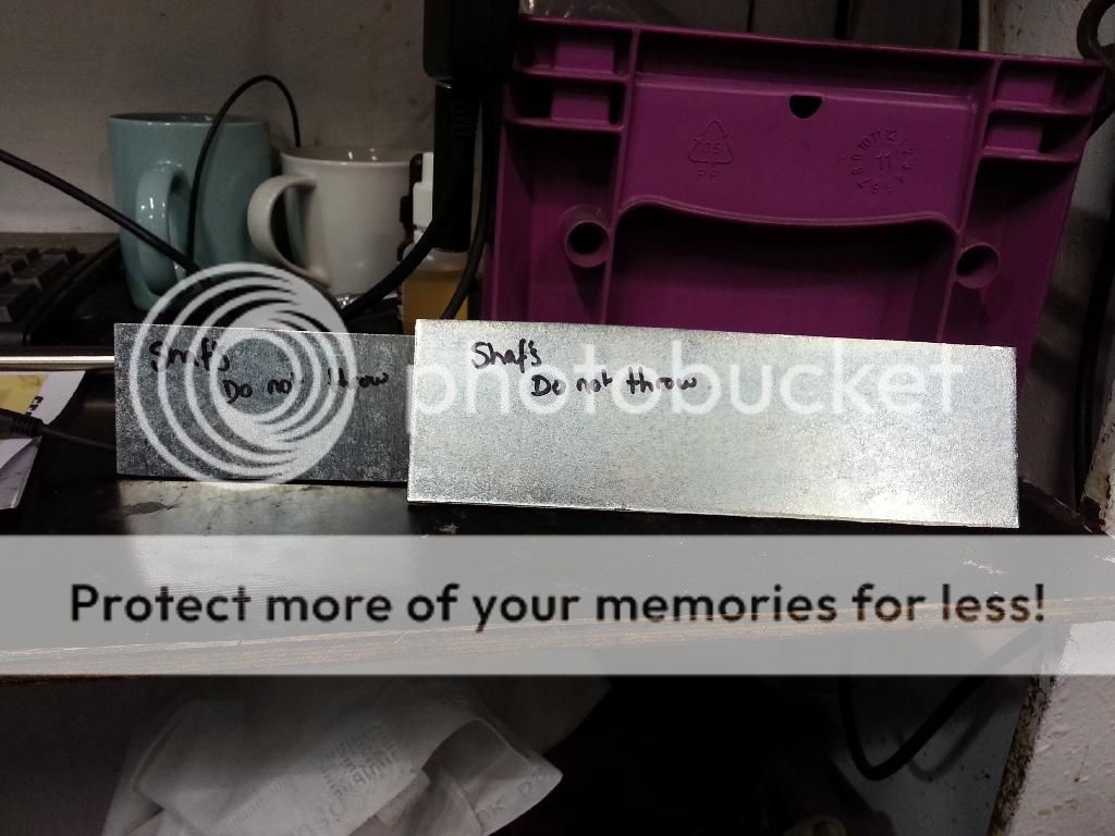

« Reply #19 on: 17 April 2014, 20:18 »
where can i get the cam locking tool?
10mm spanner  :grin: when you look at the end of the cams (when its at tdc) you can time it up by eye... kinda sounds pikey but when you see you'll notice you can't get it wrong. I had my old head in pieces and off several times no dramas regarding timing (and no tool used)  :wink:
Iv been reading the how to guide on vwvortex. I made my own locking plates lol
Mind the dodgy hand writing lols
they are 3mm or 1/8" lols
